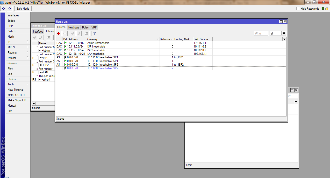

One thing more these routes are showing reachable, because the gateway is proper i.e. the DSL modem,
but the below routes are showing unreachable, in my understanding because when you put these routes without dst-address field the router adds by itself a dst-address=0.0.0.0/0. Means gateway to every route is either yahoo or google. So these routes become unreachable, and so un-active, or may be because yahoo and google won’t allow you to ping them after every 10 seconds.
add distance=1 gateway=Host1 routing-mark=ISP1 check-gateway=ping
add distance=2 gateway=Host2 routing-mark=ISP1 check-gateway=ping
Can anyone tell one more thing please. Why route to ISP2 is not active? …But again this is not loadbalancing, if only one route is active. I followed the page MANUAL PCC.

So how I am going to loadbalance then if only one connection remains active…This page of MANUAL PCC.[/quote] is total waste of time.
Plus when I delete these
add dst-address=0.0.0.0/0 gateway=10.111.0.1 distance=1 check-gateway=ping
add dst-address=0.0.0.0/0 gateway=10.112.0.1 distance=2 check-gateway=ping
Some websties open some don’t.
HOW TO LOADBALNCE? MY QUESTION IS STILL there. :frowning:

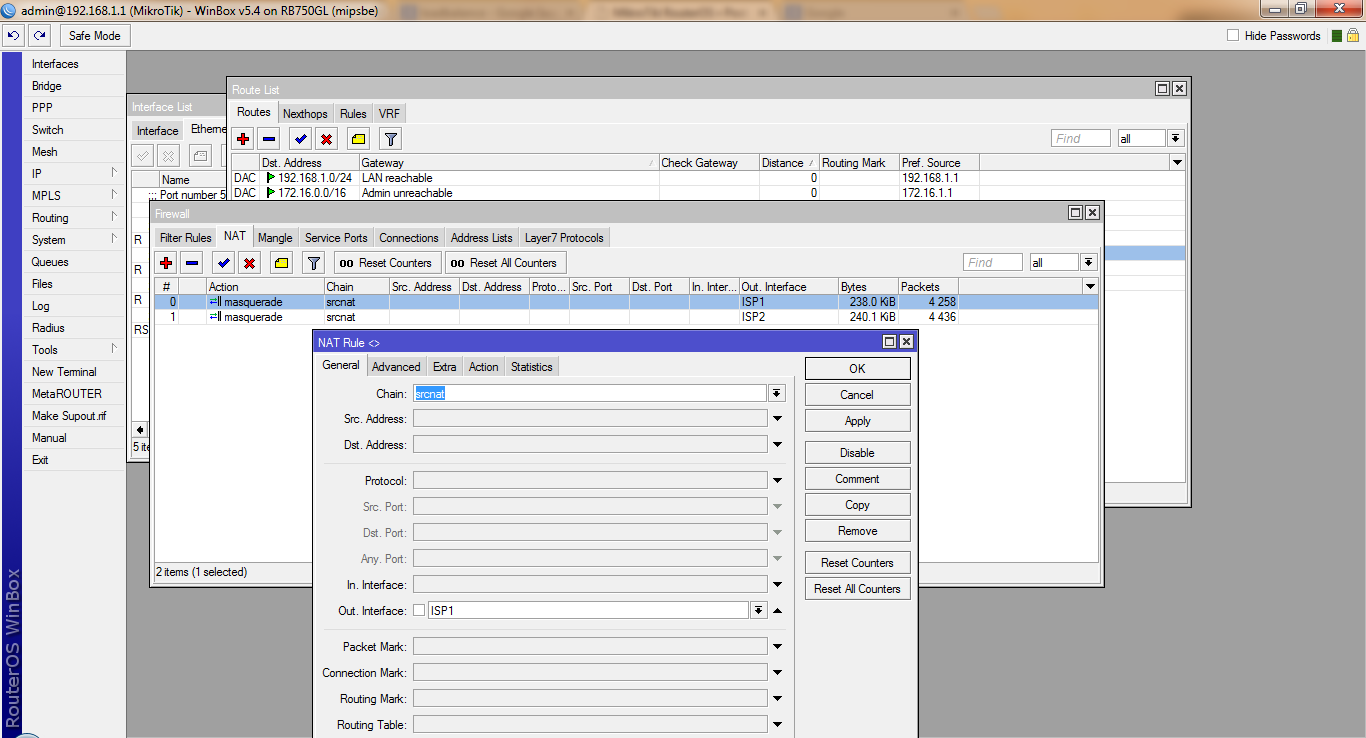

In the image there are NAT Masquerade rules. I am telling you I followed the Maunual PCC page by the inch.
And?
Sorry, this time I not understand the question…
