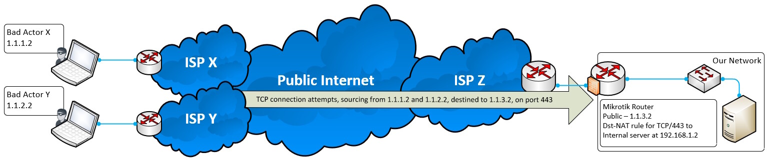

Example Topology
We have two bad actors who have discovered our HTTPS server answering requests on TCP port 443 at public address 1.1.3.2, which is assigned to the WAN interface of our router (ether1). Our DST-NAT rule is what enables requests destined to TCP port 443 at 1.1.3.2 to be forwarded on to our internal server 192.168.1.2:
add chain=dstnat dst-address=<your-public-ip> protocol=tcp dst-port=443 action=dst-nat to-addresses=192.168.1.2 to-ports=443 in-interface=ether1
The bad actors at 1.1.1.2 and 1.1.2.2 have made connections through our router, to our internal server, by way of our configured DST-NAT rule, and have observed our web application that requires some authentication to be able to use it. They attempt authentication based on guesses, which are incorrect, authentication fails and the web server resets the TCP connection, resulting in a TCP RST packet being sent. Observing these in prerouting, we’ll log them and add the source IPs to an address list named FailedTCP443AuthIPs (adjust to your liking) with a time limit of 7 days:
