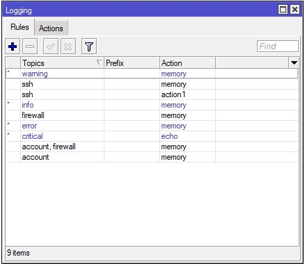

I have FTTH internet and I decided to put CR#P Huawei network terminal ( converter ) in bridge mode, and connected it to RouterBOARD 951 ( great device ). I would like to get logs for failed login attemps.
Every single ONT in ISPs IP range get brute force attack, booth on WEB interface and SSH. Username and password is unbelivebly simple so it is matter of momment when someone will pass.
I personaly log in into about 50 ONTs on ISP network and every single is under attack, it is impossible to only me dont have any login attemp. Logging conf in picture. Thanks

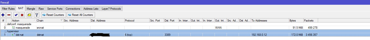

wtf? I open Winbox, deleted rules as you suggested, go to Firewall > NAT > and rule for forwardig 3389 on 192.168.0.12 ( image ) and from curiosity click on log.
In log I get allmost ton of “dstnat: in:ether1-WAN out:(unknown 0), src-mac 08:19:a6:e0:1b:2a, proto TCP (SYN), 45.82.153.171:53107->MY WAN IP:3389, len 52” does it mean someone trying to login on RDP?
Internet is full of people (and bots) trying to get into everybody’s LAN. So don’t take it personally, just get firewall tight. And, BTW, opening RDP to wide internet is a bad idea. Ideally you would use some kind of VPN to connect to your LAN. Alternatively limit allowed connections to RDP to some known WAN IP addresses (easiest way of doing it is to construct address list in IP firewall address-list and use it in NAT rule as src-address-list=).
EDIT: Watching winbox and blowing my mind. Last rule say: Drop all from WAN not DSTnated - Accept. ---- This means RB will accept every connection even if it dont have destination in LAN?
Almost there: RB will accept and forward connection if there is a dstnat rule for that port. (the rule is “drop” if “!dstnat”, and “!” here means “NOT”)
Those are your DSTNAT rules that will be allowed because they are "dstnat"ed , and as such don’t fullfill “!dstnat” required in the drop rule.
