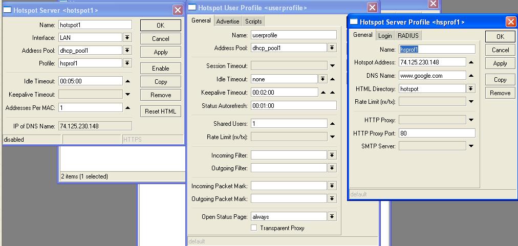

I am using hotspot without webproxy I disabled web proxy and its cache to get L7 rules works. but I faced this problem of login page.
Plz see the attache pic and guide me to correct this trouble if you need more details I will hand it to you

Try removing the “dns-name” entry for the hotspot profile. Try it again with that entry blank. That will mess up the dns for http://www.google.com and the hotspot.
ADD: Did you change the ip for the hotspot address? Change that back to the ip assigned to that localnet (192.168.1.1). When I said try http://www.google.com and that ip, I meant in your browser address bar, not these settings.
I tried removing DNS name and set IP of my local interface but no benefit.
I named local interface as LAN and public interface as WAN I thinks naming has no effect.
