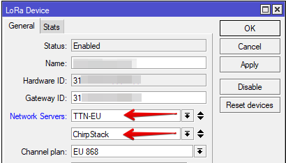

But it would be great if the gateway could also forward packets to TTN at the same time to increase the coverage for the open community.
Is this possible?
Do I just have to create a second server entry and add this to the device?
Like this:
I am a newbie to LoRaWAN.
Thanks.
Yes, if you will set multiple servers, all LoRaWAN frames will be forwarded to all the servers you have specified.
Great!
