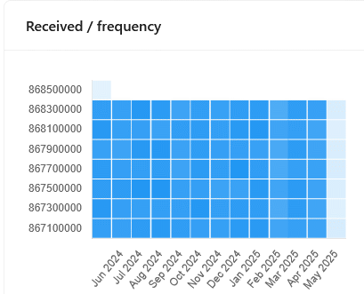

=>all channels are there (default channels configuration);
it does not show/forward packets received on this only frequency: 868.5MHz; all other channels work;
I use Chirpstack, but this should be irrelevant as the gateway doesn't show traffic on 868.5
strange=>bug?
