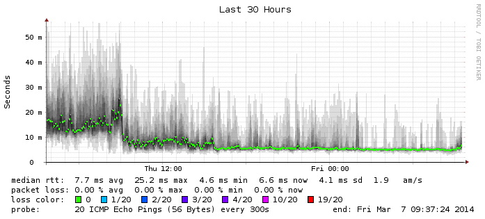

See the smokeping below of the optimized link.
  • at Thu 09:00 I switched from TDMA 3ms to 1ms
  • at Thu 16:00 I changed the MCS settings
Leo.

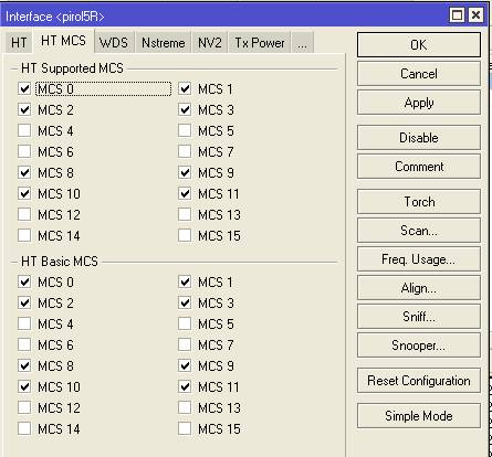

The MCS Settings for 120MBit/s
Leo

I tried playing with the MCS settings as you suggest. I’m not sure how to modify it as per your image:
  • the web interface won’t let me change anything
  • (I don’t have a windows machine for winbox)
  • In the CLI:
    it won’t let me change ht-supported-mcs (“failure: supported MCS set does not include all basic”)
    I can change ht-basic-mcs (does not improve performance [and my client says it’s still getting the MCS values I excluded]
The notation is quite confusing :wink:
