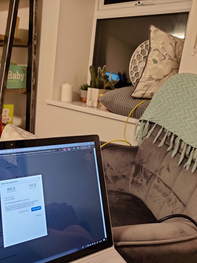

I ordered a Mikrotik LHG LTE 6 kit for my parents in law as they have similar issues.
Decided to test it before installation at their house.
To be honest it exceeded my estimations, professionally propped it up on windowsill on some cushions and it made 60-90mbps on EE.
So I am thinking of upgrading to the new LHGG as it seems the best option around £200?
The POE gives me much better placement options than I can achieve with the antenna cable length on the current set up and with the test above hopeful I can get some great speeds.
It does feel however that the device it calling out for a higher CAT modem to take advantage of the upgraded internals? Any rumours?

You have 60Mbps what is good for 2x 4K movies and you probably can wait with that limitatiom :slight_smile:

@Sib, current rates are like 15mbps so I am hopeful the newer LHGG mounted outside will outperform the set up I was testing below would be nice to get close to 100mbps! I think the chateau option is too difficult from a mounting point of view.
