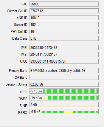

I use in my home network hAP AX Lite LTE /L41G-2axD&FG621-EA/.I have good cell signal coverage and this device meets my needs!
