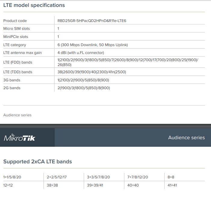

https://cdr.pl/p7084,mikortik-routerboard-d25g-5hpacqd2hpnd-r11e-lte6-bezprzewodowy-router-lte-kat-6-trzypasmowy-z-mesh.html
MIKORTIK ROUTERBOARD Audience D25G-5HPACQD2HPND&R11E-LTE6
LTE FDD 1, 2, 3, 5, 7, 8, 12, 17, 20, 25, 26
LTE TDD 38, 39, 40, 41n.
2G (2, 3, 5, 8)
3G (1, 2, 5, 8)
slot miniPCIe
antenna u.FL.
For all Poland ISP we have all Band’s we need: 1+3+7+8+20+38.
Question is about Carrier Aggregation in R11e-LTE6 - on what band’s will be CA working. We must wait for official announcements.

CA now is supported on r11-lte6
I have got “SXTR rev2 & R11e-LTE6 kit” by 1 day.
SIM are not up/down but a/b.
2CA works. Cell/SectorID lock works for primary band and second one “ca-band” works automatical. This lock is now save inside modem, we not must use modem-init.

I can say several things about LTE cat6 and CA.
I own Mikrotik Audience LTE with mentioned modem.
Carrier aggregation works for e between channel 3/7 and 1/20.
