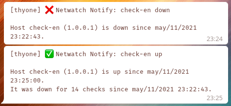

I love RouterOS more each day. I asked myself - I wonder if the router could send an email when the link fails. Yup - baked in SMTP client :slight_smile:
Use my scripts and it will even send Telegram messages. :wink:
This is from testing the configuration I posted above:
