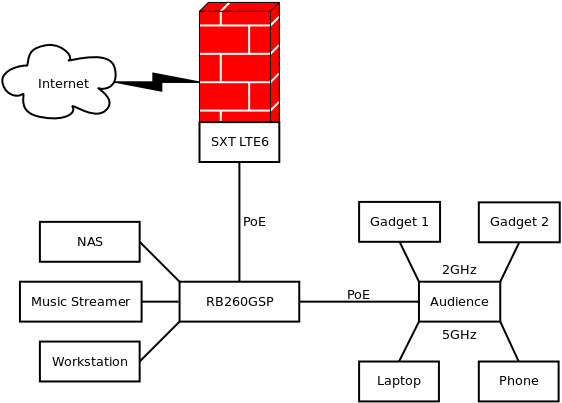

The Audience hardware seems quite capable so at first I thought I would pass through my external IP to it and use it as my main router, doing firewall, VLANs, etc.
Fig. 1

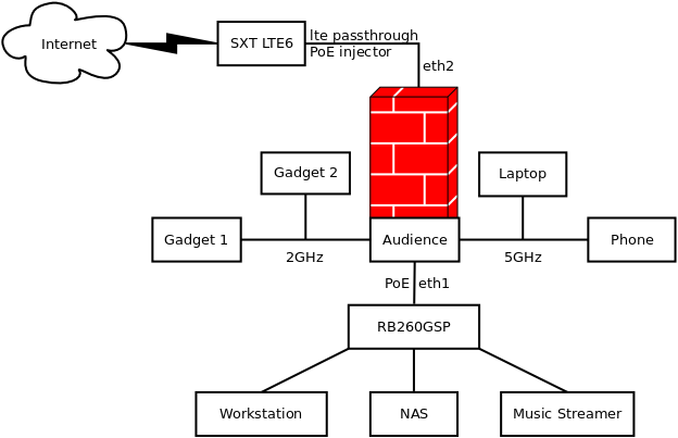

But then this setup seems a bit more straightforward:
Fig. 2

The SXT LTE6 will probably handle basic NAT and firewall for a LTE connection just fine. I would probably go with Figure 2.
If you need heavier inter-VLAN routing then you could use the Audience, then default out via the SXT.

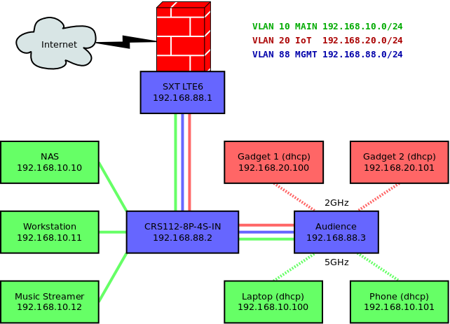

I am sure the SXT would be fine as a basic outside firewall, gateway router. I just wanted to make sure that I avoid any inter VLAN rouiting-on-a-stick scenario. I’ve posted the same question on reddit and got the suggestion to ditch the RB260GSP and go with something like CRS112-8P-4S-IN which has Layer-3 capabilities, VLAN switching, ACLs, and more ports for future expansion. Looks sweet and fits nicely in my Fig.2 proposed setup. No need for IP passthrough this way either. I am looking into this now. Wish it had 2 SFP+ instead 4 SFP ports so I can put the NAS on a 10GBit line! Can’t see any smallish (8-port) desktop PoE switch with a SFP+ cage in the current line-up. Still looks good enough for now. The CRS328-24P-4S+RM is a monster of a switch but quite frankly – an overkill for my home.

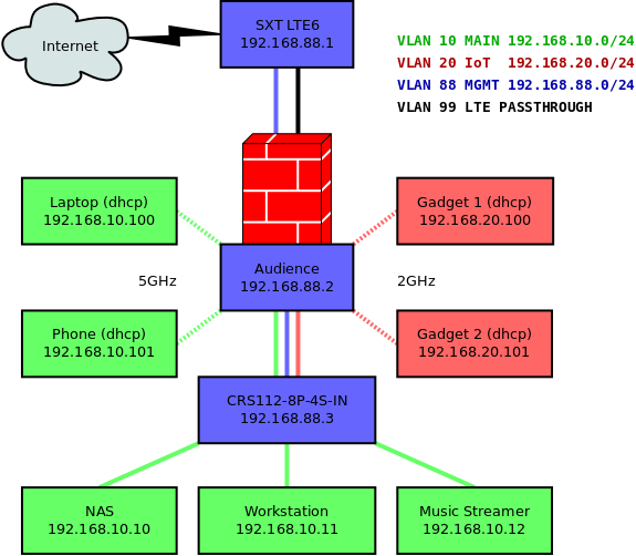

CRS112-8P-4S-IN is nice and can indeed do L3, but not with the performance of the Audience.
You could for example create the following a “LTE uplink” VLAN that goes between the SXT and the Audience.
All clients defaults to the Audience, then the Audience defaults to the SXT. NAT is done at the SXT.
I am trying to visualize what you say because I struggle to wrap my head around it otherwise. Does something like this seem reasonable to you:
Fig.1
Or the alternative:
Fig.2
I am even more confused than when I started trying to comprehend the packet flow and performance implications of each approach. I am about to give up on the whole VLAN segregation thing and do it simply: SXT (router/gateway) → CRS (switch) → AP. Some more reading is due before I try more complex setups.
