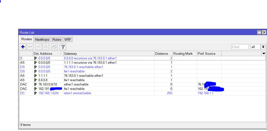

Hello, I just bough an https://mikrotik.com/product/wap_lte_kit and would like to do the following:
-lte1 is receiving a public DHCP address from the APN (WAN)
-ether1 is with WAN
-wlan1 is the LAN (with dhcp server and NAT)
I can manually play the failover changing the distance of the ether1, however I would like to find a script that could work with lte1
Thing is:
Info I found is related to scenarios in where you need to modify the routes, in the case of lte1 interface is not possible to enable the check-ping or add the route manually, so I was thinking if possible to use recursive routing like here https://help.mikrotik.com/docs/pages/viewpage.action?pageId=26476608 to do what I need without touch the lte routes.

No success, but one strange thing is that when ether1 lose connection, LTE works only to ping 8.8.8.8 (no other routes are possible)
