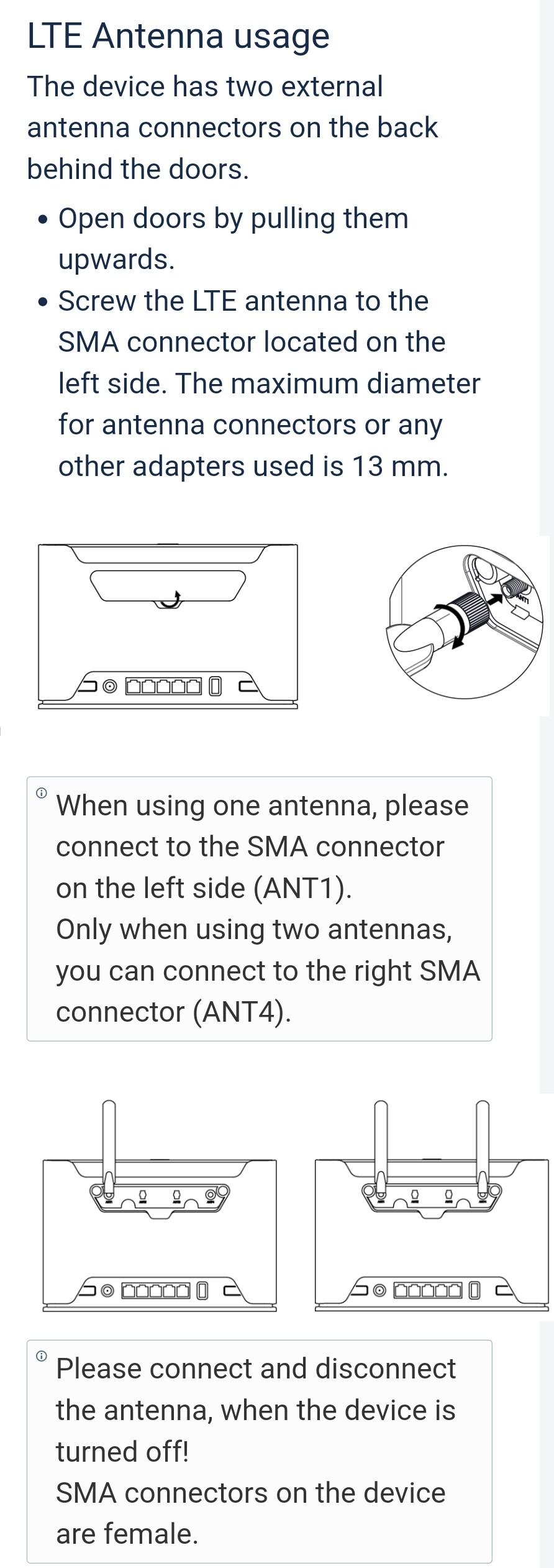

Something like this ? https://mikrotik.com/product/chateau_lte6_ax#fndtn-specifications

Yea, but here he can attach external antennas like Iskra P-56,

Indeed, external antenna with the Chateau model could be possible right ?

I thought buying some SMA cables (3m) and connect the passive low gain antenna to the cables.
Then I just need to drill 2 holes for the cable and fix the passiv antenna outside.
Good idea or not ? :slight_smile:
If you have towers near you and the signal is strong then go for it, you can always upgrade to better antenna.
