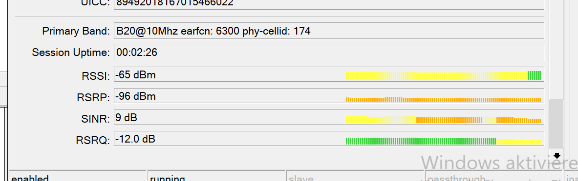

I tried to use an atl18. Thats my result:
Is it worth to try other mikrotik hardware with external antennas?
Thanks for feedback!

B20, mentioned in your screenshot, is 800MHz band. None of Miktotik’s antennas are particularly good at sub-GHz frequencies (to put it mildly). And I imagine there isn’t any usable signal in higher frequency bands (B3-1800MHz, B1-2100MHz, B7-2600MHz, etc) or else your ATL would already be using it. Unless orientation of your ATL is wrong - ATL’s antenna is narrow-beam directional antenna and you have to direct antenna directly at cell tower.
RSRP at -96dBm is not great, a decent external antenna might increase it above -90dBm (which is still not great but useful) and improve RSRQ by a few dB (which would help as well).
But you should not expect miracles: if there aren’t any signals on higher frequency bands (for CA), then you’re limited to around 100Mbps (DL) which is throretical maximum of a 10MHz cell with 2x2MIMO (a norm on low-frequency 4G and 5G cells) … and you have to share air time (read: throughput) with the rest of active users, served by same cell.

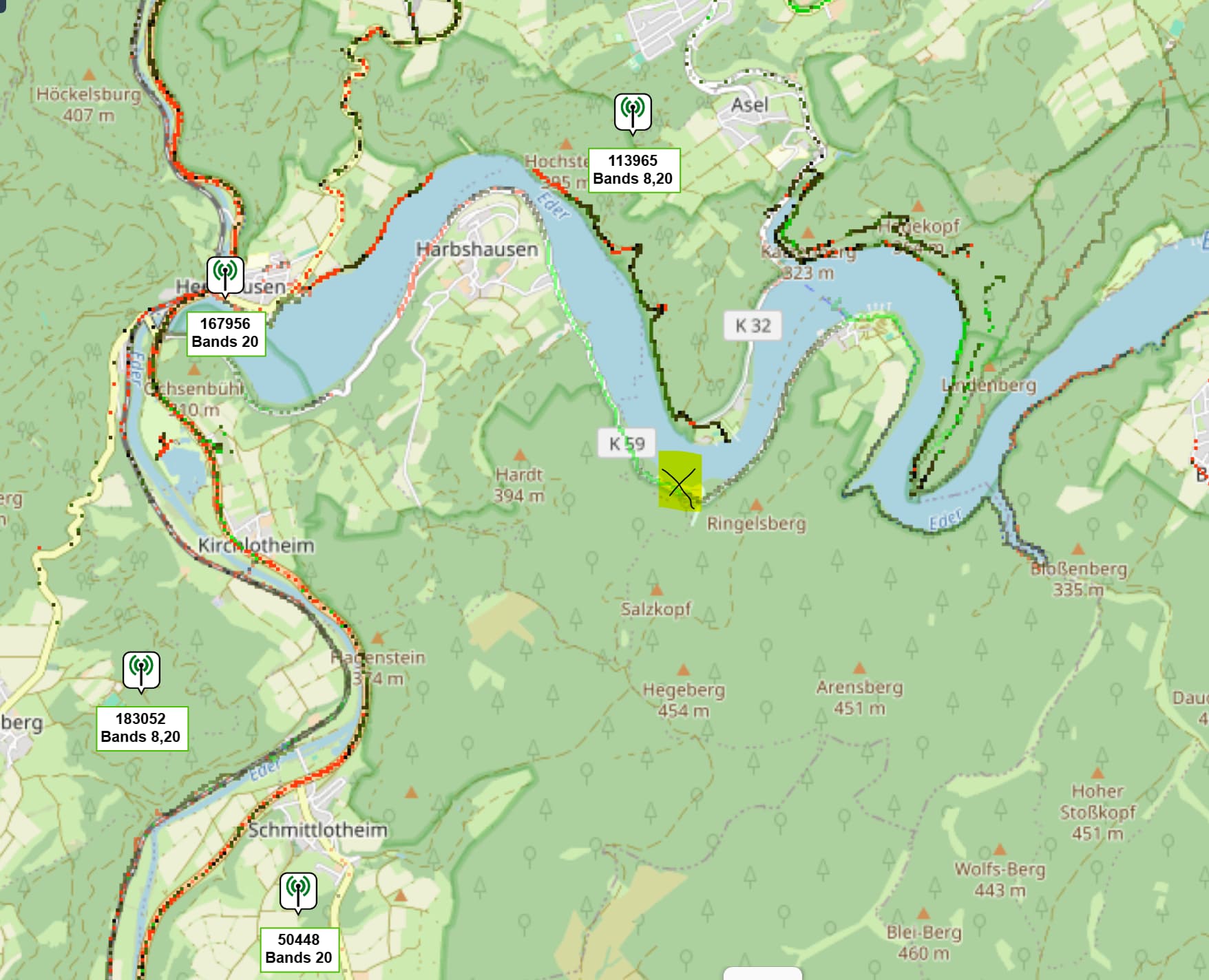

I sitting somewhere here:
The problem is that there are “big” mountains… I could get like 10mbit download at max…
Straight connection up to satellites is preferred then …
