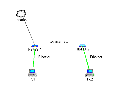

This really should be simple, but I’m convinced there’s something I’m missing. I’ve been through every article in the Wiki that I can find on the topic, and I have been through Mr. Burgess’s book “Learn RouterOS” a few times now but I’m still hitting the same wall. Setup is basically as follows, although I’ve system reset this thing a few times to start over from scratch.
RB433_1
Set the Gateway to 0.0.0.0/0 → 192.168.1.1
Eth1 is 192.168.1.41/24
Wan1 is enabled and set to 192.168.2.1/24
NAT masquerade is enabled.
Tools - Ping can ping all internal interfaces, as well as the gateway.
RB433_2
Eth1 is set to 192.168.88.1
Wan 1 is enabled and set to 192.168.2.2
0.0.0.0/0 → 192.168.2.1 is set as default gateway (edit)
Tools - Ping can ping all internal interfaces, but cannot ping the gateway or the other side of the wireless link.

Set RB433_1 to station-wds, and RB433-2 to slave-wds. Both routers saw the other register. pinging on the wds1 interface of both routers results in being able to ping the far side of the link, but unable to ping itself. Is this normal behavior?

I tried out your setup and it did not work. I tried using both wlan1 as the gateway interface, and no interface specified with no luck. ARP pings and standard pings did not work on the wireless link to the far side, 192.168.2.2 or 2.1. Local interfaces pinged properly.
I’m not so sure about the default gateways being the same. Assuming Mysterious’s setup, how would RB433_2 know to look for 192.168.1.1 on anything other than eth1?
