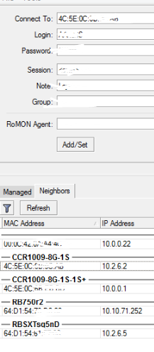

if you need MAC telnet for Windows - Winbox :slight_smile:
Again, Winbox is not telnet and has no telnet
If you want Telnet https://en.wikipedia.org/wiki/Telnet then use any Telnet client.
If you want MAC Telnet MikroTik RouterOS proprietary protocol https://wiki.mikrotik.com/wiki/MAC_access then use Winbox and type Mikrotik router MAC address https://en.wikipedia.org/wiki/MAC_address in “Connect To”.
