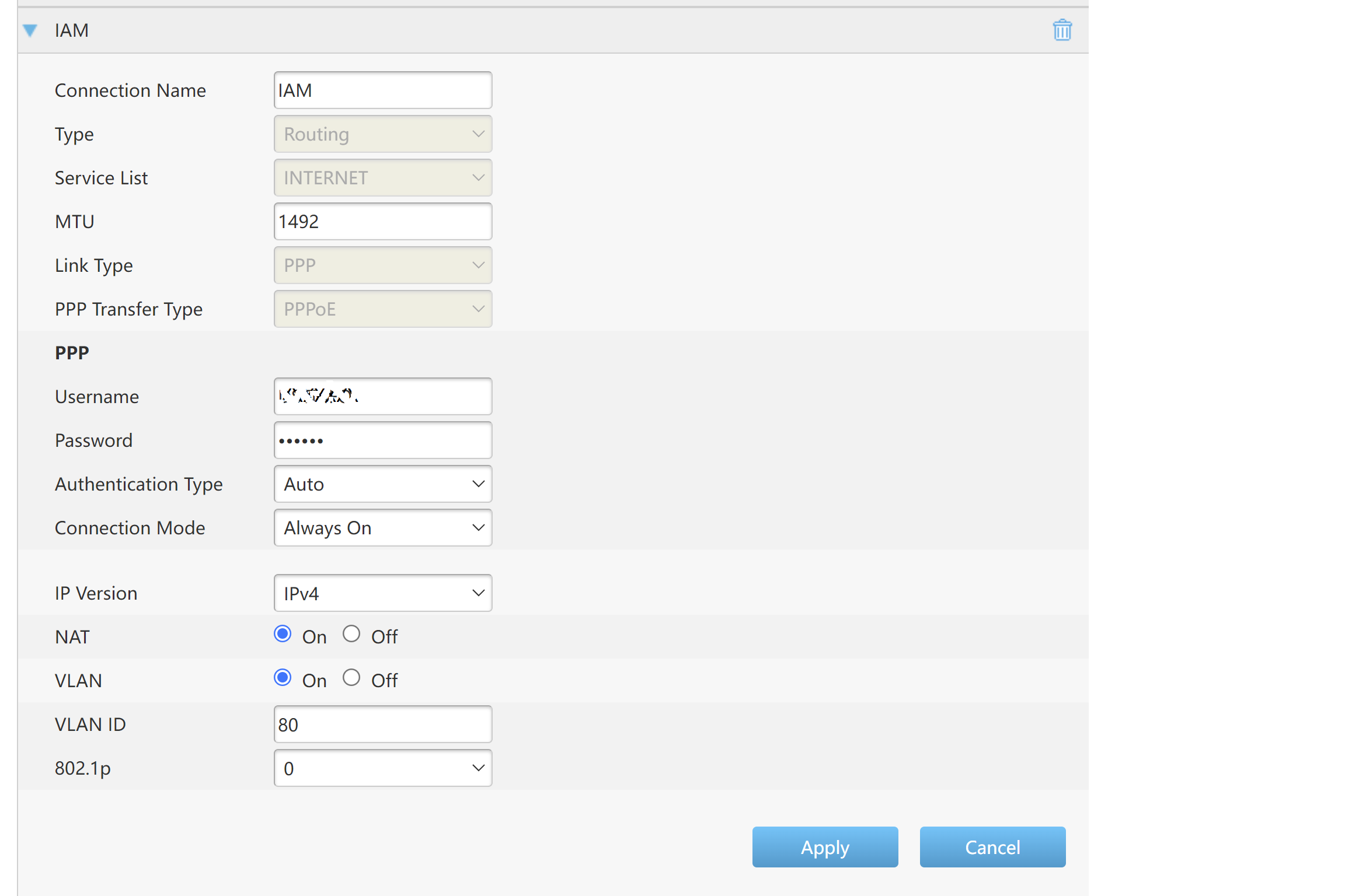

→ The modem give me a static address: I can see it in IP/Cloud
→ PPPOE or VLAN? I don’t know what to answer! In the Modem WAN config, I have a PPP user and pass + VLAN turned ON with an ID (See attached).
When I turn OFF VLAN, I lost internet in my MT.
Thanks in advance.
