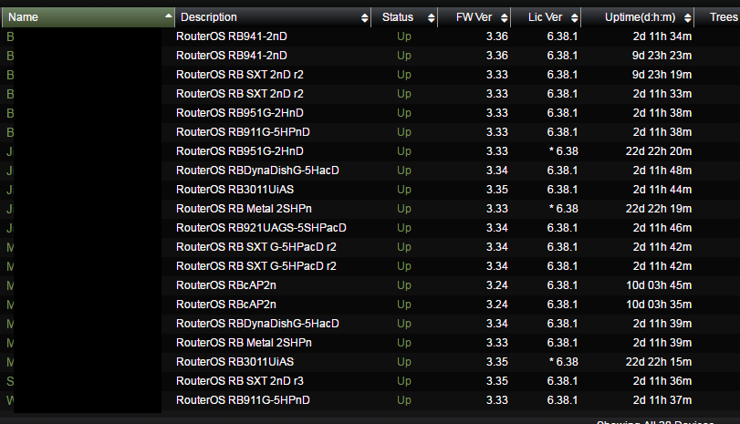

I only have ~20 Mikrotik in my production network. With this small amount (and since they are all different) I still do any configuration by hand, but for updates and monitoring I use 2 different things.
  1. I use Cacti’s Mikrotik plugin to keep track of firmware and software versions. It uses SNMP to pull the information from the devices, and displays a * next to any firmware or software that isn’t the latest. It does some other things too, but I don’t use those parts (Trees, Users, APs, etc..). I use Cacti itself to graph all my interfaces, voltages, temperatures, etc… and I use the Weathermap plugin to make a visual representation of my network so you can see at a glance where any bandwidth links may be having issues.
  2. I use Ansible to automatically push updates to everything. I use it since it allows me to do the updates serially (one at a time, in the order I specify). I particularly needed this since if they are rebooted in the wrong order, then you will lose connection to the next ones in the list. You can ofcourse have it updating multiple at once if you need it to. It just connects in via an SSH key and runs the command to update / reboot.
