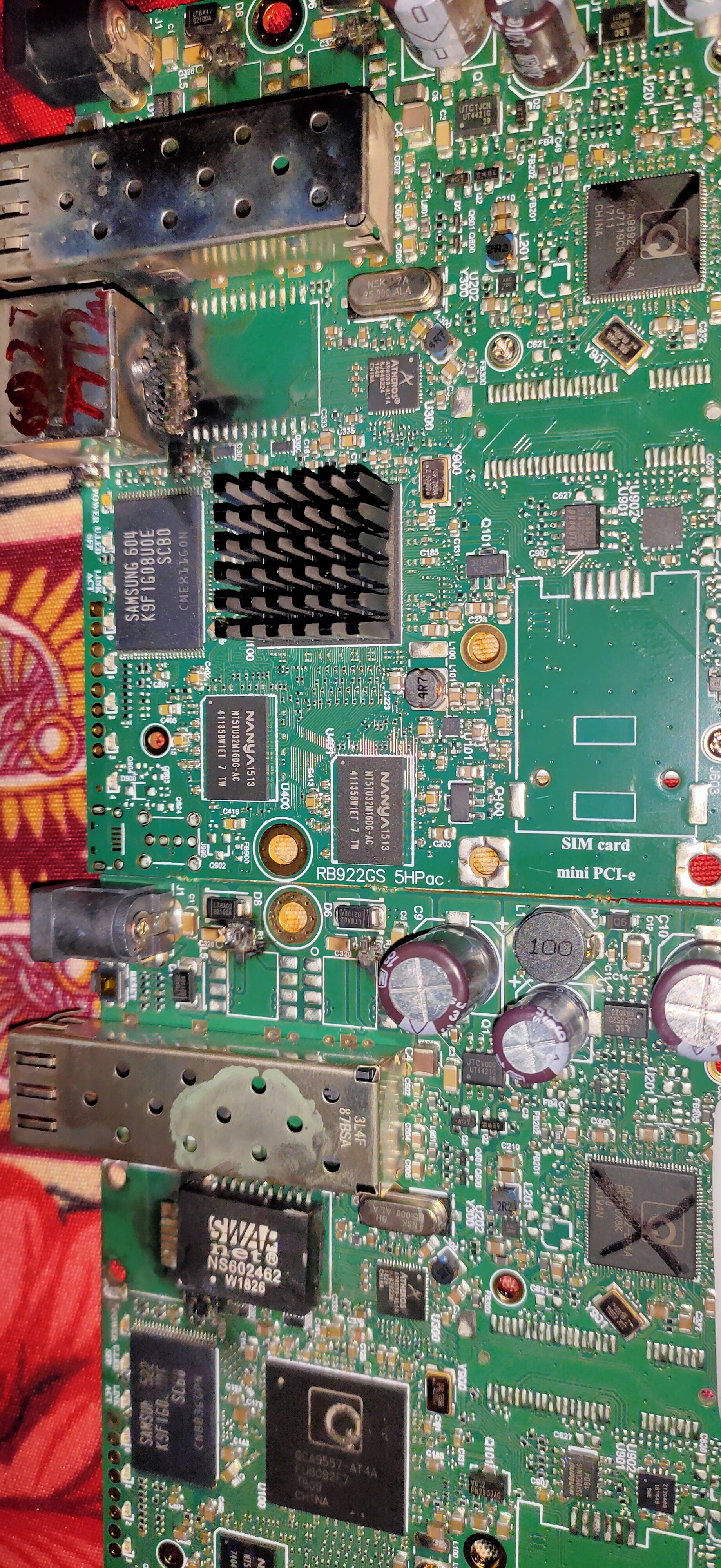

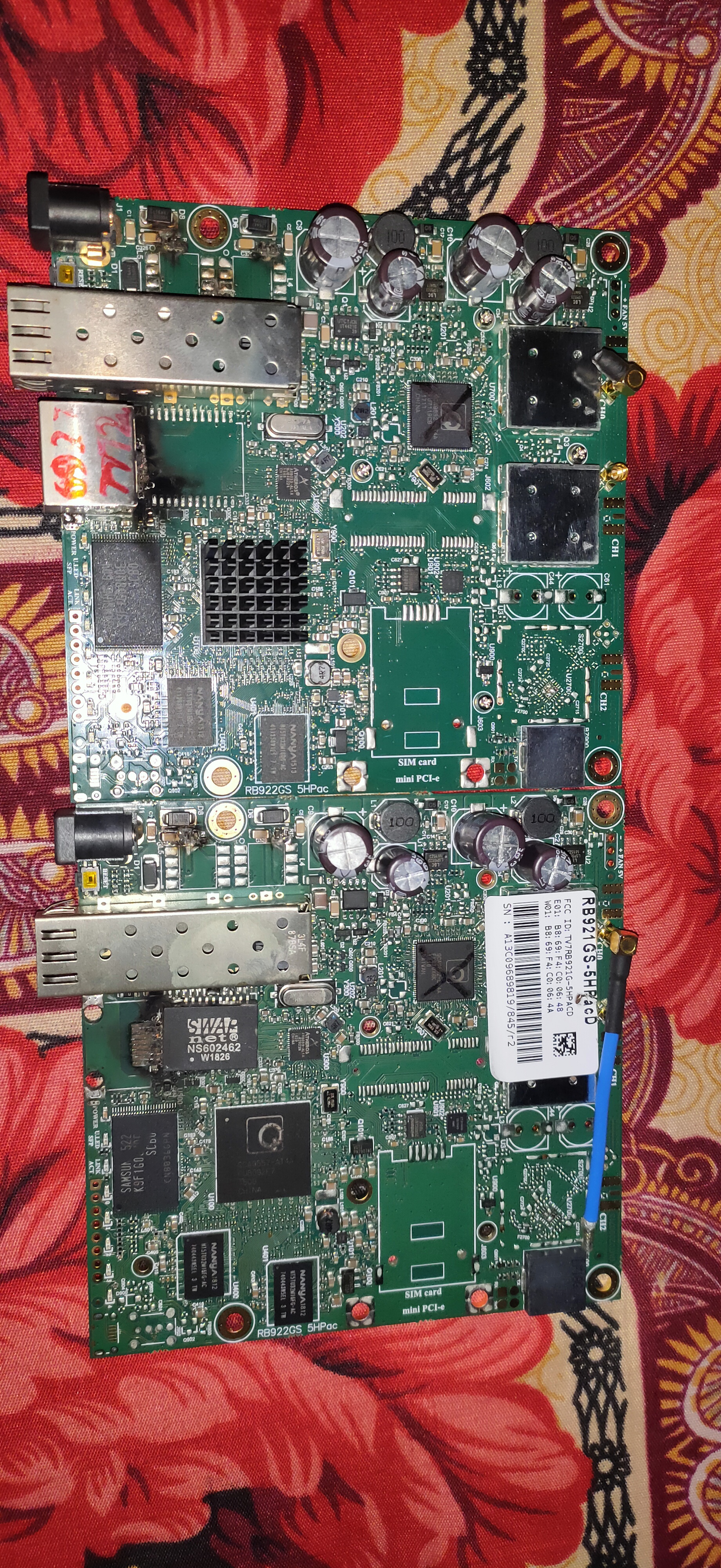

I am using 2 mantbox 19s , Ther are two mobile tower besides my office, So i placed mantbox on both tower, each one. Without any high power, both mantbox and their poe had burnet and melted.That time weather was fine, no lightning ther. Although their 24 volt adaptors is working fine. One sector was in under warranty.
How it happened ?
As my mantbox 19s stopped working, then i placed a ubnt sector 120 degree with basebox at same place. but not satisfied with the client devices signals. is ther any changes required ?
