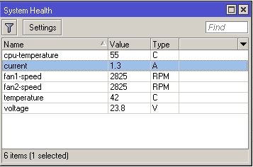

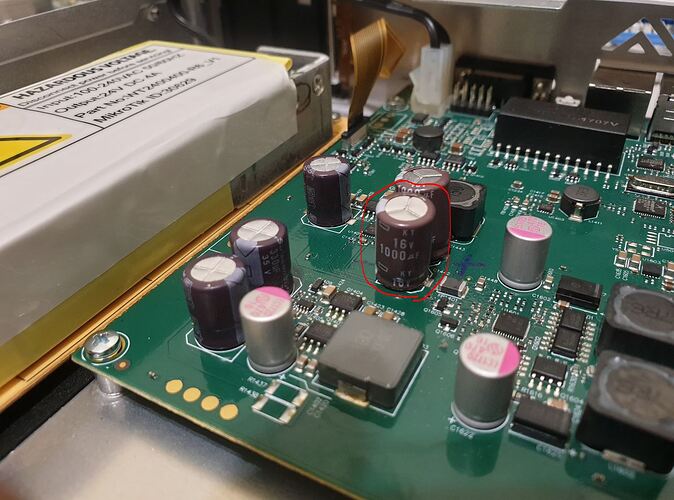

I just replaced my C1442 / C1443 with a little bit larger capacitance and voltage rating Japanese capacitors. 16V / 1000uf. (Original 6.3V / 680uf)
It works very well, my “health” voltage rises up from 22.0-23.00 Volt to very stable 23.8-23.9 Volt.
