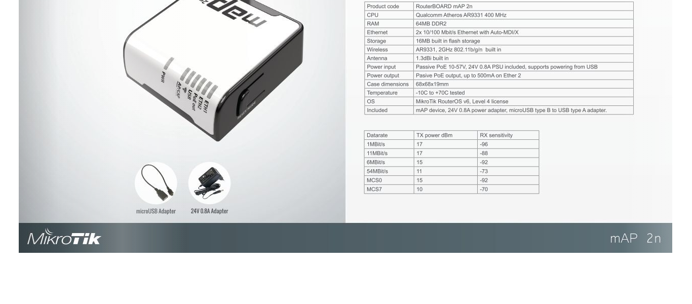

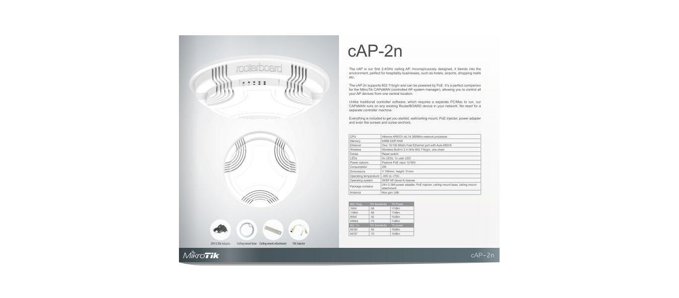

The mAP2nD has Dual Chain wireless, the original mAP2n is very similar to the cAP2n and only has a single chain wireless:
As @hectae explained: mAP2n has single wireless chain. The “2n” part of the device name refers to wireless capabilities and it translates to “2.4GHz radio supporting 802.11n, single chain”.
Thanks, I was not aware that there was also a single antenna variant!
