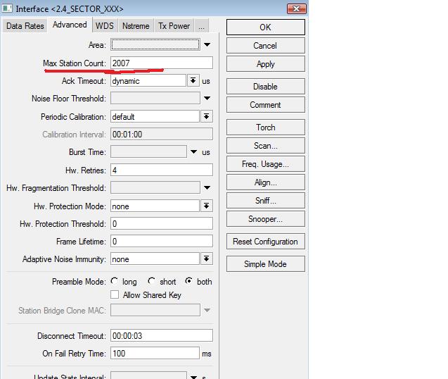

Thanks. Is there any type of setting where I can hard code a limit on the number of devices that can register? I’ll have several RB’s with the same SSID, the hope is that I can max it at some number (let’s say 30) and it will refuse connections and the client will attempt to register with a different RB.
under the advanced tab of the interface you can set max connections
