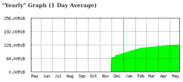

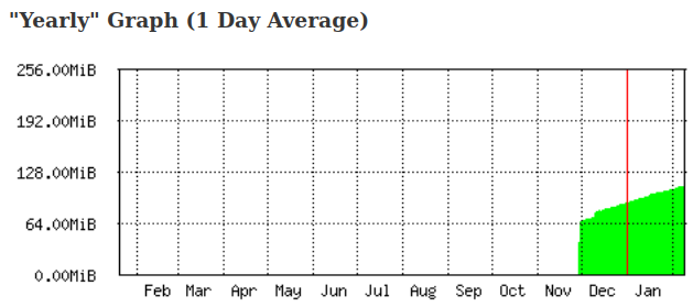

Thanks for the response. ROS 7.16.2. I’m not worried, just curious :slight_smile:
I am curious if memory will run full.
Here is a partial answer to your question. It seems to have reached a plateau.
