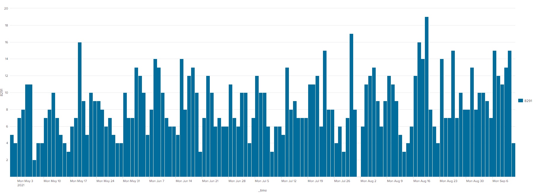

This shows number of hits on my router on port 8291 Winbox, last 4 month. It only counts one IP for each user a day, since all who tries to access a non open port are blocked for 24 hours. There has been no increase of traffic.
