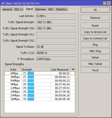

I have two AP “Access Point” that about every 1.5 hours disconnecting!
I have configured two AP as indicated on the guide http://wiki.mikrotik.com/wiki/Wireless_WDS_Mesh works perfectly except for this problem!
If I configure the two devices one as AP and the other as station they work perfectly without errors!
I have attached an image where you can see that the signal is good.
In your opinion what can be the problem?
