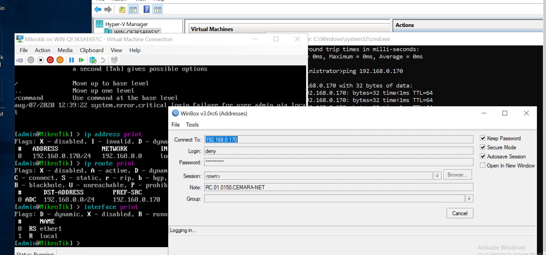

Hi, first of all i’m completely new at ROS so please bear with me, i’m trying to migrate my x86 ROS machine to CHR under hyper-v server 2019.
I set the virtual switch to external, create network adapter and connect it to vswitch
Followed the first time config guide here
https://help.mikrotik.com/docs/display/ROS/First+Time+Configuration
then i was able to ping CHR from the host as seen on the pic,
however when i try to login via winbox, it’s stuck at logging-in,
any idea?
I have tried disabling the unrelated NIC’s and turn off firewall.
Winbox service already running as well
If you’re completely new to this, then why are you using an ancient version of Winbox (3.0rc6) and where/when did you get it?
Something doesn’t quite ring true…
You didn’t mention which version of CHR you’re trying to use either.
Ah solved, it’s asking for newer winbox version lol
