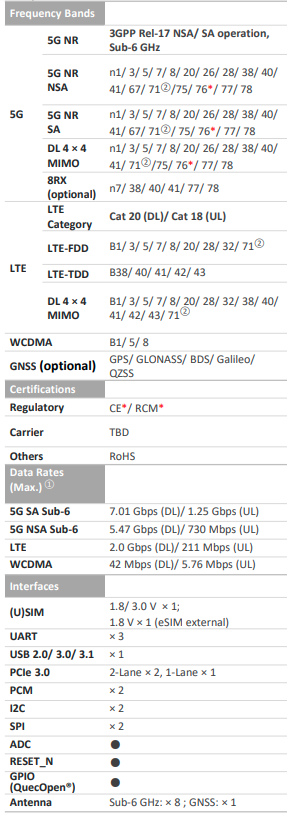

Very surprised to see Chateau R17 being equipped with RG650E based on X75. The main advantage of this module is its diverse aggregation capability on NR in SA mode for a total of 300Mhz (so up to 3x NR bands), however full 5G SA adoption in lot of EU countries is still lagging behind and seem to be at least year away. This means, the promised speeds of up to 7Gbps are very much theoretical at the moment for lot of buyers and I have to wonder whether high price will be justifiable as a long-term investment on a device that is supposed to be all-in-one. Certainly waiting two more years will give you cheaper modem of same or better capabilities and bonus upgrade in Wi-Fi technology. Mind you, this Chateau still does not come with even WiFi 6E so it is already out of date, and will be more so in two years time. Maybe stepping down to RG650V would’ve been more appropriate for this Chateau model while leaving RG650E for standalone external 5G CPEs.
5G/NR on normal/mid bands (FR1) will never ever get you 7 Gbps. For that, you’ll need a 5G radio that supports FR2, but the trade-off is a much smaller coverage area and you’ll have to be within 50 meters of the base station antenna to get that kind of speed.
RG650E does not support mmWave. It’s theoretical speed based on standard and it is possible to satisfy it with n78A_n78A_n78A combo (total span of 300Mhz) which is what it is based upon. However, this configuration is supported only in SA mode, not in NSA mode where only two NR bands can be aggregated. Obviously real-world performance will be much lower, however my point is that you are paying for device that will not be able to unleash its full potential for another year or two, and it is enclosed together with ancient Wi-Fi 6 (not even 6E, let alone 7), making it a rather poor long-term investment.

None have worldwide band support*, so I’m in same boat as before — ZERO Mikrotik LTE/5G products to use. Even beyond that, the low memory and CPU specs mean none are useful for multi-wan, which is annoying… other than, it just not working at all in US is bigger problem. And I have a bunch of custom 5G wAPGacR that all need to be replaced because 16MB of flash is too risky, so WTF are they doing still shipping 16MB flash devices. RouterOS clearly not getting smaller over time.
Mikrtotik cannot seem to understand that folks might want a 5G model with “global” bands. And, yes, that be a higher cost, pass it along it fine. My alternative (Pepwave) are 2-3x cost of any Mikrotik equivalent. Quectel makes a bunch of variants, some include all bands & they seem to want to save a few dollars.
Instead of 10 worthless products instead of 5 good ones with multiple SKUs. Clearly some folk might pay for more memory/CPU, beyond just global bands.
Not the case actually. Global variants have more band coverage but worse aggregation abilities. Clearly, MikroTik cares more about better speeds and connectivity in Europe than they care about global coverage. Can’t blame them for it, and NA specific variants from Quectel are somewhat uncommon, so they likely do not want to sell sub-par product to US which will have maximum speeds lower than what EU variant has.
