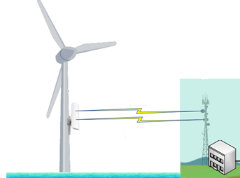

Hi all,
I’m trying to “design” and then implement the following scenario. A PTP 6Km radio link between an eolic tower and another Tower.
The first eolic is 6 Km over sea (so i need IP66 enclousre), the second tower is in coast.
Maximum throughput 10mbps.
My question is, what kind of antennas do i must use to establish the link?
I saw qrt 5ac, and DynaDish 5, but they are not IP66??
Thanks for your help and suggestions
Regards,

I’m pretty sure it will handle.
I don’t think any antenna system has IP Code in datasheet.
I have a PTP link using QRT 5ac for same distance, 6km over a plain field. Both QRT are mounted on 20m height on water tower and 25m on a granary ( grain elevator) since december 2015.
It has been pass throught 2 winters and enought heavy rains and are still online. In fact, link never went down since installation ( obviously both are grounded and are connected to UPS too ). From this point of view i am pretty sure that are quite resistant to weather conditions from your scenario.

Putting the device on the sea is something different than just on plain land. I would rather enclose the device into another enough resistant plastic box.
It might be hard to find boxes that fit DynaDish or qrt. Even so, you must to build a strong mount for a thin plastic. Water sealent might help.
I’d either dissasemble and tropicalize the QRT, or go straight to a enclosure + RB (and tropicalize it too), e.g. RF-Elements Twistport adapter or the like.
QRT is going to stand weather (to a degree, sea/ocean climate is really corrosive), given its cost, it may be easier to just preventively replace units on a year or bi-year fashion than to try to make them corrosion-proof.
The key here is choosing the most integrated and self-contained product, the less mechanical connections, i.e. the less connectors, the better.
Pay special attention to the RJ45 receptacle, as that’s the typical point of failure corrosion-wise. Either use some putty after plugging the cable, hot glue, or anything to prevent air to reach the RJ45 connector pins.
