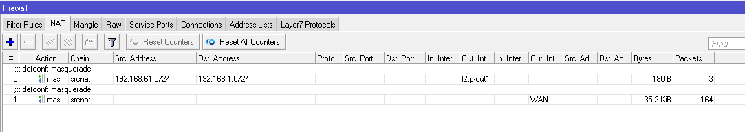

OK, traffic in one direction is resolved with a masquerade rule on the spoke side.

The masquerade is a band-aid. If you want bidirectional communication, don’t use masquerade, instead create routes in both directions.
