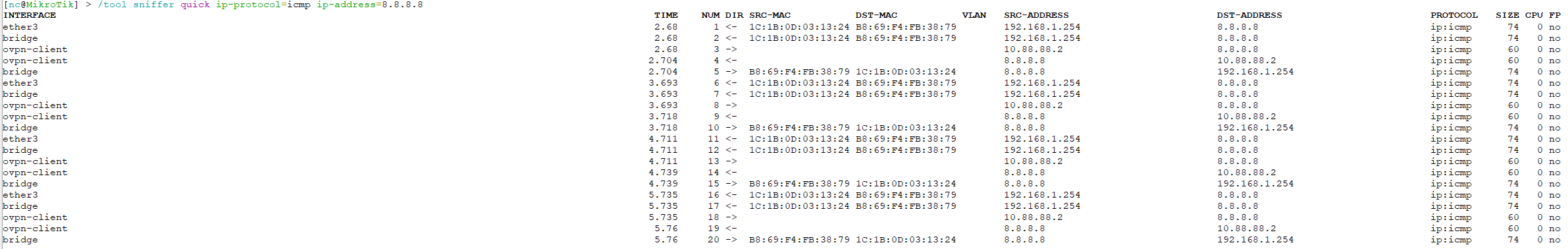

Do I read you right that you cannot ping from the command line window of a Windows machine connected to the Mikrotik?
If so, what can you see if you run /tool sniffer quick ip-protocol=icmp ip-address=8.8.8.8 on the Mikrotik and start pinging 8.8.8.8 from the Windows?
Damn, now I can’t ping from mikrotik anymore, and I didn’t change anything, routes look the same, I don’t get it.
But yes you’ve read it right, I couldn’t ping from windows machine directly connected to mikrotik but I could from mikrotik terminal.
I stil tried your proposal even thou I can’t ping from winbox nor cmd
INTERFACE               TIME    NUM DI SRC-MAC           DST-MAC           VLAN
ether3                 1.861      1 <- 1C:1B:0D:03:13:24 B8:69:F4:FB:38:79
bridge                 1.861      2 <- 1C:1B:0D:03:13:24 B8:69:F4:FB:38:79
ovpn-client            1.861      3 ->
any other ideas?
Well, the first one is to make the CLI window as wide as your screen allows and run the sniffer again. The sniffer output above shows that the ICMP echo request packet arrives from the PC and is forwarded via the openvpn tunnel, but due to narrow screen it doesn’t show whether it has been properly src-nated. In any case, the issue is at the openvpn server side. If the request is properly src-nated, I’d think about firewall and/or NAT issue at server side; if it is not, it depends on the network design whether the server should be aware of 192.168.1.0/24 being accessible via your client or whether the server is a 3rd party one and the private subnets of the clients are irrelevant for it.

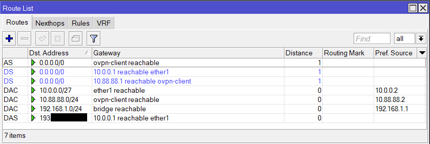

Hmm, I think the problem is in routing. I actually got it to work when I connected to ovpn, then I disabled route 0.0.0.0/0 to gateway 10.0.0.1 (main router), and I actually got the right public ip and internet worked. But then the tunnel disconnected and didn’t want to connect anymore until I added the deleted route. Then of course internet stopped working. The OVPN server is mikrotik.

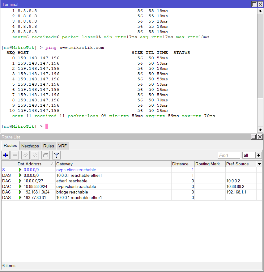

ok, disregard previous post, I did the config from scratch, now it works. I didn’t do anything different afk.

How can I manipulate with routes so that I can make 0.0.0.0/0 ovpn-out AS ?
It depends on what you use the VPN for.
If you don’t want your ISP to know what sites you are browsing, or you want to bypass regional restrictions of some content provider, use the VPN provider’s DNS. And make sure you redirect any DNS queries sent by the clients directly to the DNS address other than the one you’ve assigned them to the VPN provider’s one.
If you don’t care about either, you can stay with your ISP’s DNS.
I don’t get the question - you screenshot shows it already is AS…?
Yes, but in the first screenshot (second post) it wasn’t, that’s why it didn’t work.
Here I got lucky, because I couldn’t reproduce dynamically that ovpn-client route was the AS.
But then I researched a little bit and I saw I have to put route distance on dhcp client (ether1) on 2 and then I get the ovpn-client route AS or DAS (if I check the add default route under PPP interface).
