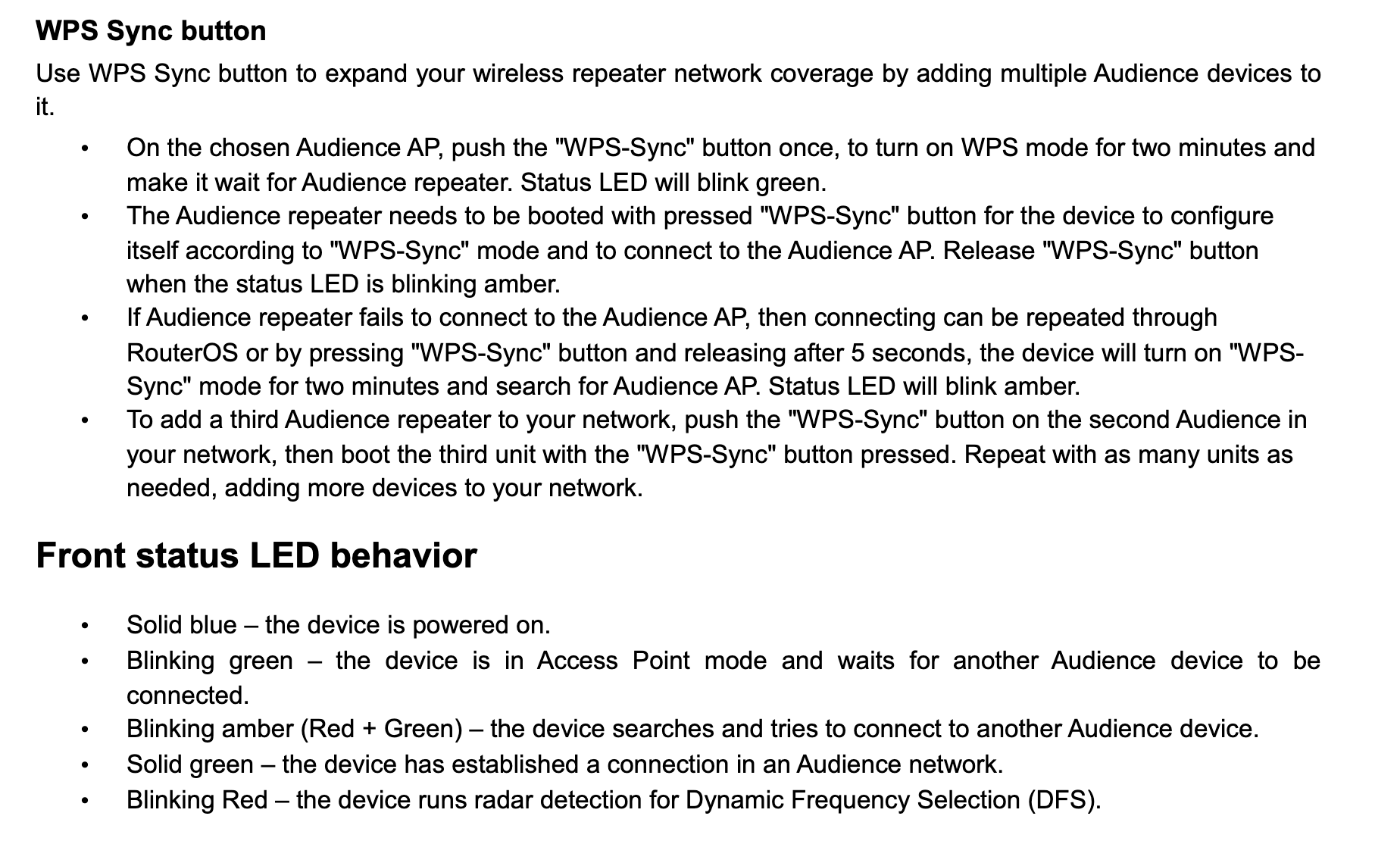

Looks like these devices have a “join to mesh” button. Is that just reset with cap mode?
Yes, basically that. MikroTik devices are versatile, these are no different. They are just preconfigured for something you can do yourself.
Here is the button description from the manual:
Normis,
my audience LTE also shows sometimes a “solid green” light ???
No clue what that is as its not mentioned in the user guide.
Any idea?

I meant I get a solid green light, but I have only one audience and only set up as
an classic AP!!!
So no mesh mode or capstan etc..
Sorry for confusion (as said I have turned them off already some week ago…)
