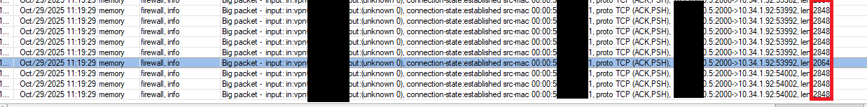

I’m running routerOS 7.20.2. I have a L2TP VPN and a TCP MSS adjust rule on my output traffic to change the MSS on Syn packets. When the Btest tool runs, the server sends packets of size 2848. The MSS is set to 1410 inside the tunnel. I believe btest is ignoring the MSS on SYN packets.

My understanding is that when I change the MSS on an an output SYN packet, that instructs the other side receiving that SYN to set the MSS to that number. However, the other side is sending the oversized packets (I’m running receive only Btest from the client that has the mangle rules I pasted above / collecting logs on input from the same).
