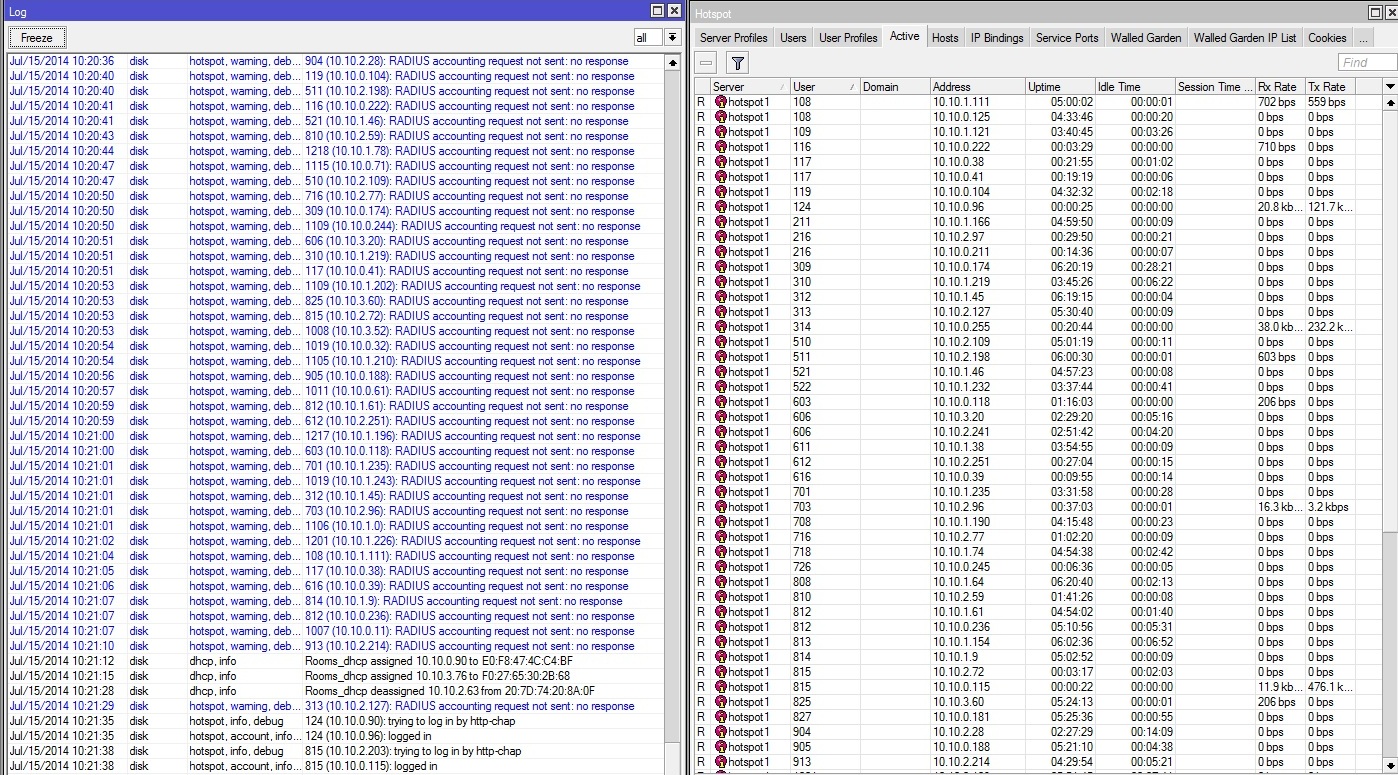

I disabled the Firewall layer 7 protocol as requested from the support but the problem remain the same!
