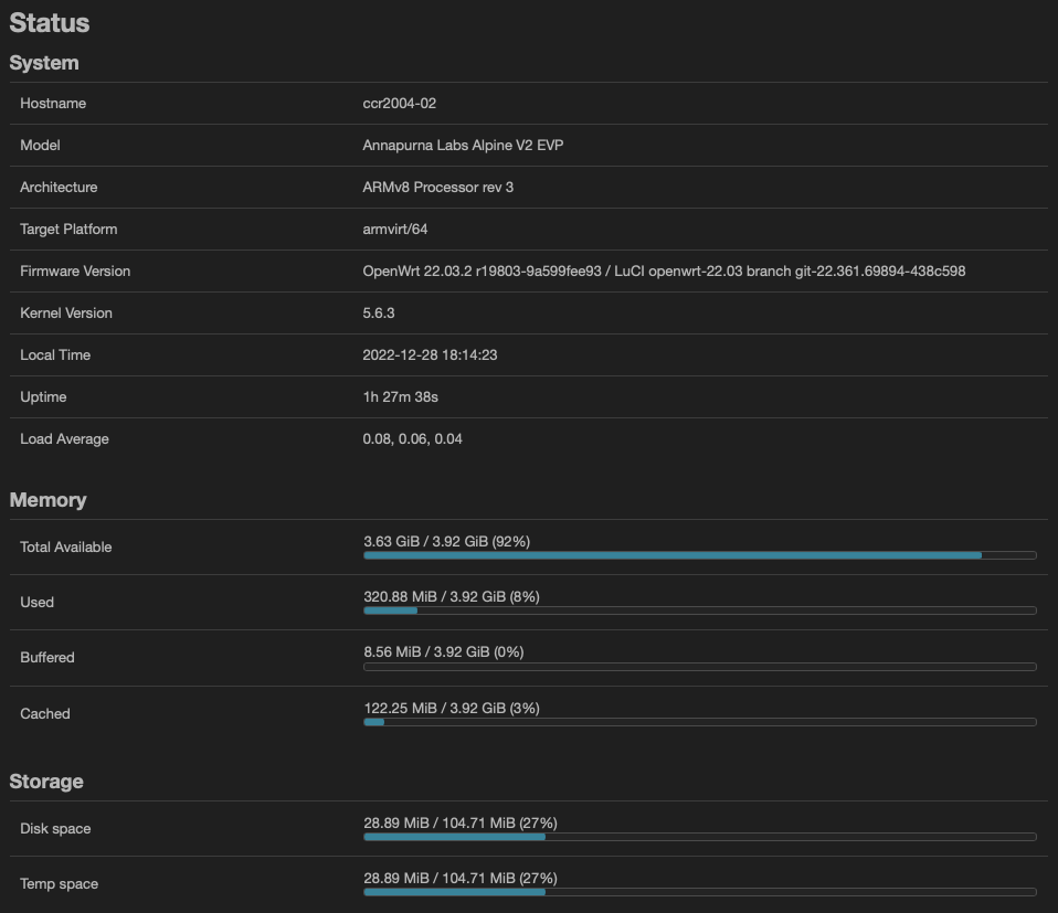

Downgraded my router to 7.6, then got the container working. Snapshot versions don’t have a GUI, so this is what I ended up preparing for the router.
docker import https://downloads.openwrt.org/releases/22.03.2/targets/armvirt/64/openwrt-22.03.2-armvirt-64-default-rootfs.tar.gz openwrt-arm64
docker save openwrt-arm64 > openwrt_arm64.tar
And with that, we have a GUI:

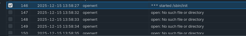

I played with openwrt, create and delete container. it was ok, but for testing i used internal memory for storage. So finally i decided put usb drive and setup it properly. Day before i did upgrade to routeros to latest 7.20.6 and now container not starting, once i click start it write “open: No such file or directory” (see images attached)
FYI, i’m using exact command from the post above (change file path and root-dir accordingly).
I did downgrade to 7.19.6 and now openwrt container can run. So issue related 7.20. Didnt try 7.21
