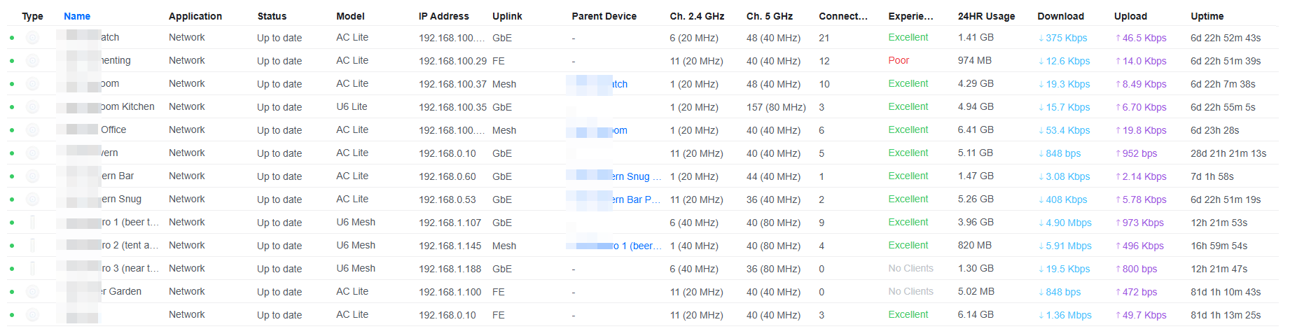

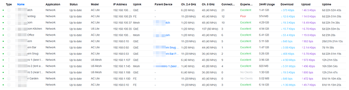

It's hard to defend the lack of an overview like this too...
