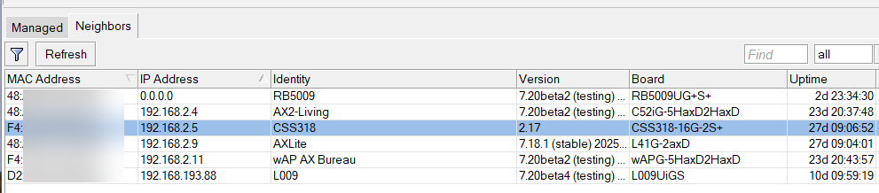

Example from another SWOS device:
Yep, i.e. if the PC has an IP in the same range of the switch.
I stand corrected, see below post, so it means “as long as the switch has an IP aasigned”?
No, it doesn’t matter, it can discover a switch even with different IP range, because MDP works on L2 level.

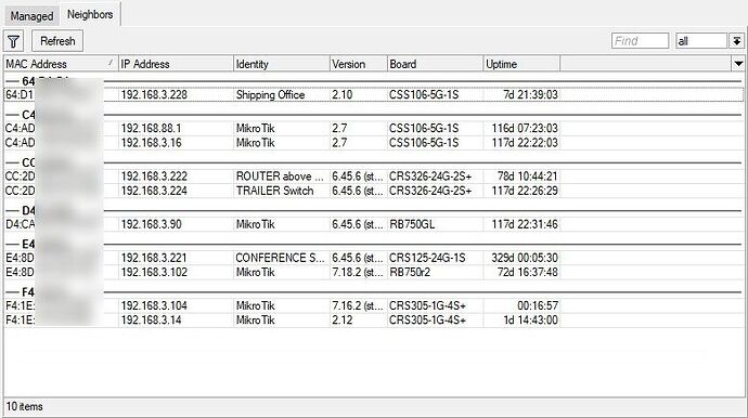

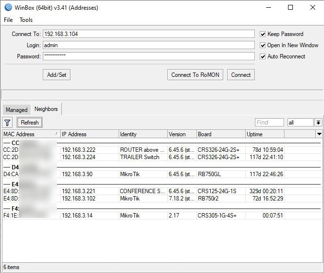

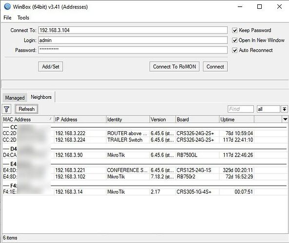

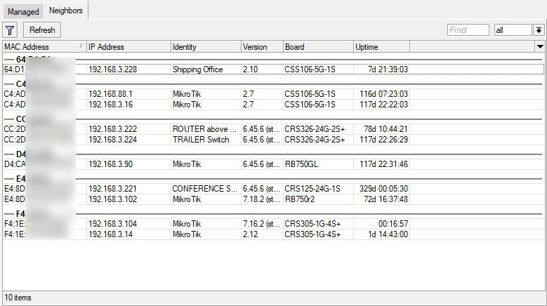

After reading some of the responses, (Thank-you) I went back to it. This time WinBox showed TWO connections to it. (strange) 3.104 was the IP I assigned to the RouterOS. 3.14 was a DHCP address it found on it’s own. Can it be running BOTH RouterOS and SwitchOS at the same time?

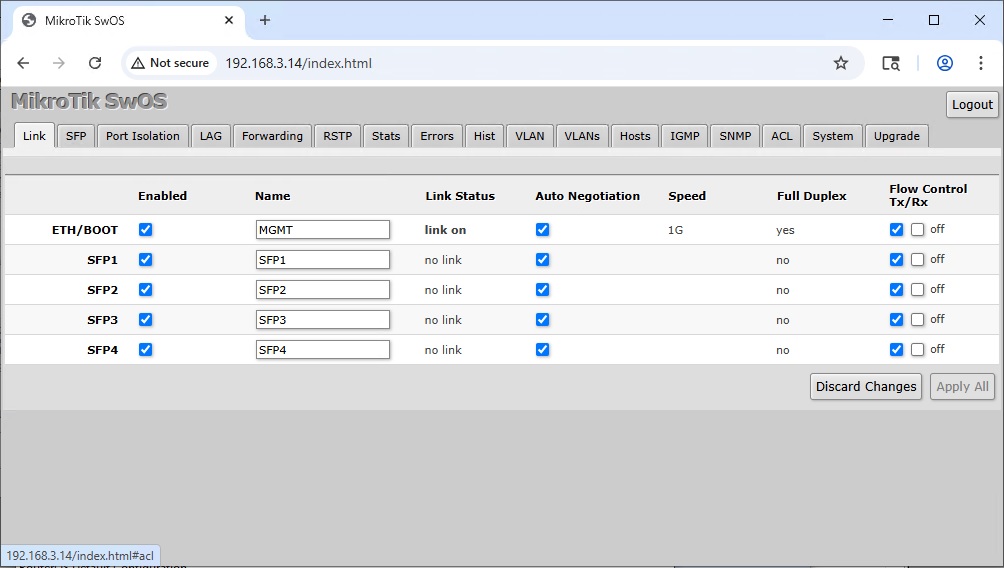

So then I logged on to SwitchOS (3.14) found the password was blank, so corrected that. Then checked updates and upgraded to v2.17 SwitchOS. After requesting reboot, oh darn, was going to try to connect with WinBox as RouterOS… After the upgrade, the RouterOS was no longer a neighbor.
It upgraded, I logged in, it shows “no link” on each of the SFP devices, BUT I can also see, it is talking to each of the SFP devices; although they are not fiber, but RJ45 connections.

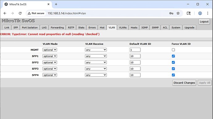

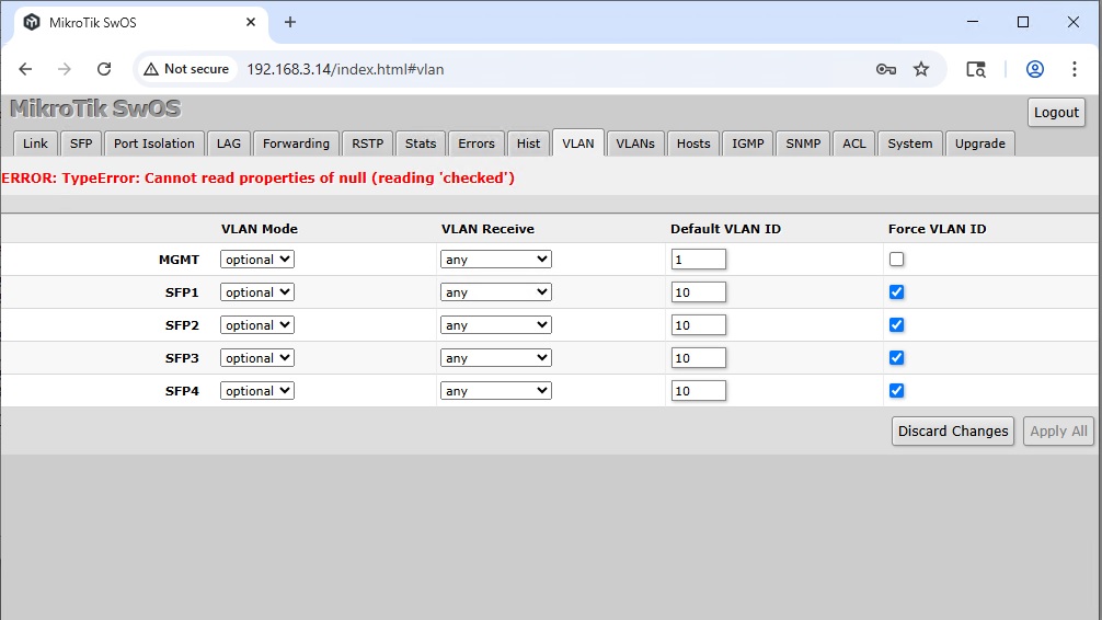

I set the SFP devices to VLAN 10 forced to isolate them from the internal management side of the switch.
No change to “Link Status” though.
On your first screenshot:
Why it shows 2 IP addresses, probably a left over from some ARP cache or so ?

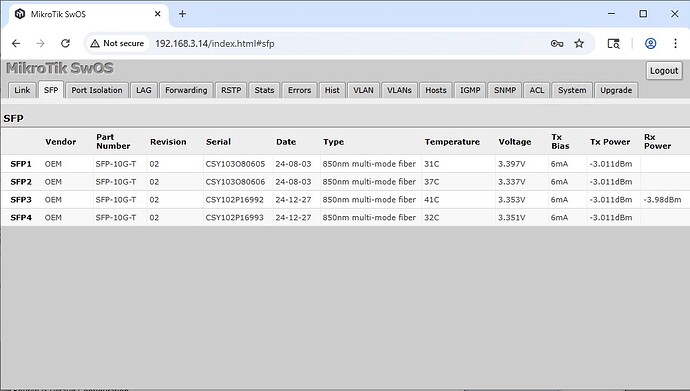

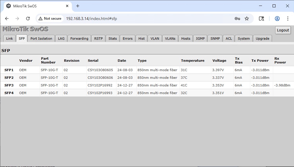

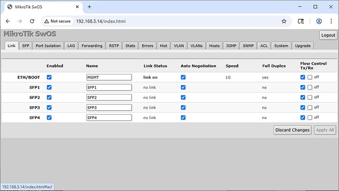

On your 4th screenshot:
You say these are ethernet SFPs (SFP-10G-T) but they are being recognized as 850nm multi-mode fiber connections ?
Maybe you need to remove autonegotiation and set them manually ?
Just curious: why not use ROS ? You will get a ton more features. Do these modules work via ROS ?
Bingo, that turned out to be the cat’s meow. It was not negotiating with the SFP modules, as soon as I TOLD them how to connect, it connected.
