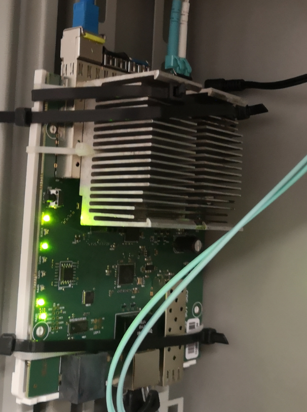

The CRS309 has 8x SFP+ ports and on the back heatsinks. If I juse use S+RJ10 module in slot 1 and use the 7 and 8 for the 10G fiber transceivers, could that be run (as suggested in S+RJ10?
The CRS309 is here 1/4 the price of the CRS312.

All modules perform trouble free up to 88F ambient seen recently but I wonder what happens when S+RJ10 steps up from 2.5G to 10G.
No, it doesn’t matter (much). The problem with 10Gbps over UTP cables is that Tx amplifiers for 10Gbps are very energy ineffective, UTP cable category doesn’t change this much. And the inefficiency means that excess ebergy is converted into heat, but SFP modules aren’t designed to dissipate lots of heat (no heat dissipation surfaces, only contact with SFP port case which then has to be cooled this way or another).
Optical modules are much nicer in this regard, so your idea about use of CRS309 (one RJ-45 module, the rest optical modules) would probably work.

This matter of 10GBase-T Modules will be increasing with the advent of XGS-PON into mainstream
If only the router had a SPF+ slot for the LAN side or the MikroTik switches a 10G RJ45 slot then there would be no problems. I could have 25Gbps internet here for the same price as I have the 10G one. Only difference is the setup fee. Monthly rate is the same. But having already trouble getting 10G to work (properly), I’d even have more troubles for 25G.
My way … the World without zip ties will stop :slight_smile:
Zip ties in electrical engineering and telecommunications … and PU foam in civil engineering :laughing:
Do not forget silver tape which holds both worlds together :slight_smile:
