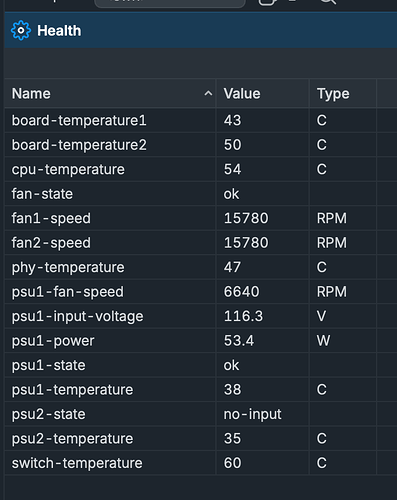

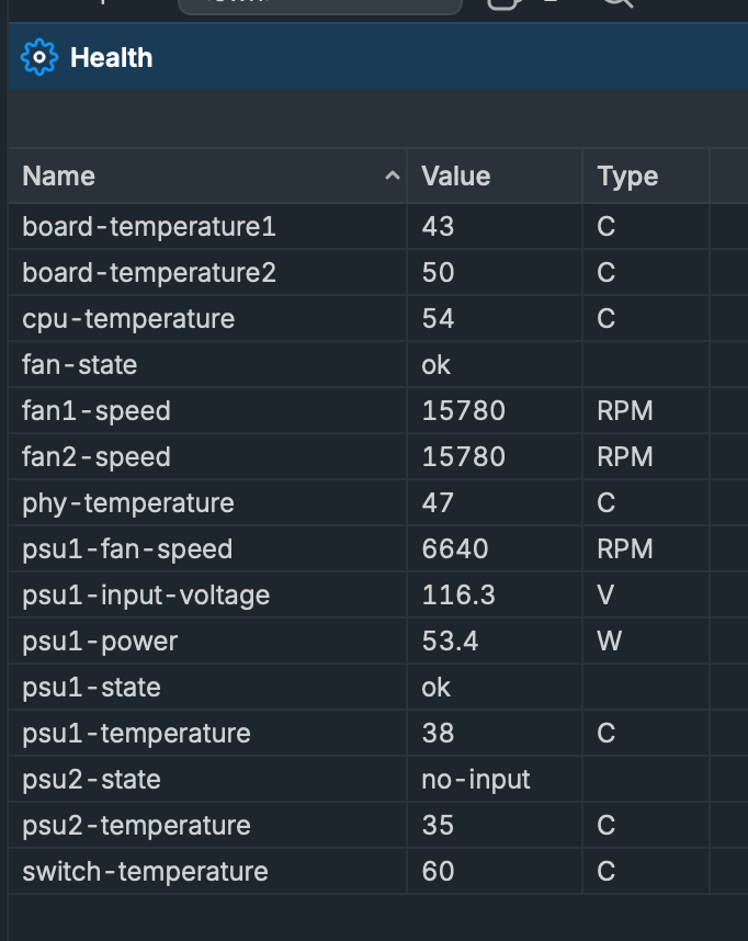

I went down exactly that path (update first, then look at temps). Unfortunately it didn't resolve it, so let me post a full write-up in case it helps others, because I think this is a fan-control bug rather than a real thermal event.
Hardware: CRS804-4DDQ-hRM RouterOS: upgraded to 7.23.2 (stable) — and the RouterBOOT firmware (/system/routerboard upgrade) to 7.23.2. No change in fan behavior.
Symptom: both chassis fans ramp to ~15,800 RPM (max) while the switch silicon is cold. Critically, the fan speed inversely tracks temperature — the fans spin up as the chip cools. It oscillates in bursts every few minutes (loud → calmer → loud).
Representative /system/health print during a loud burst:
cpu-temperature     50C
switch-temperature  56C
phy-temperature     34C
board-temperature2  50C
fan1-speed          15780
fan2-speed          15960
fan-state           ok
So the silicon is ~50 °C below the 105 °C overtemp threshold, yet the fans are pinned at max. (The PSU fans sit at ~4,500 RPM and aren't the problem.)

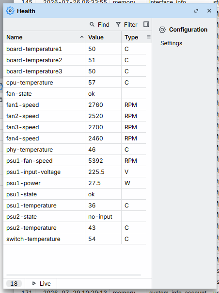

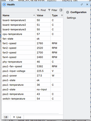

I have a CRS812 (same switch chip) and with 4 sfp28+ connection the fans speed are:
disabling ports does not reduce rpms (room temperature is 31.9° celsius).
