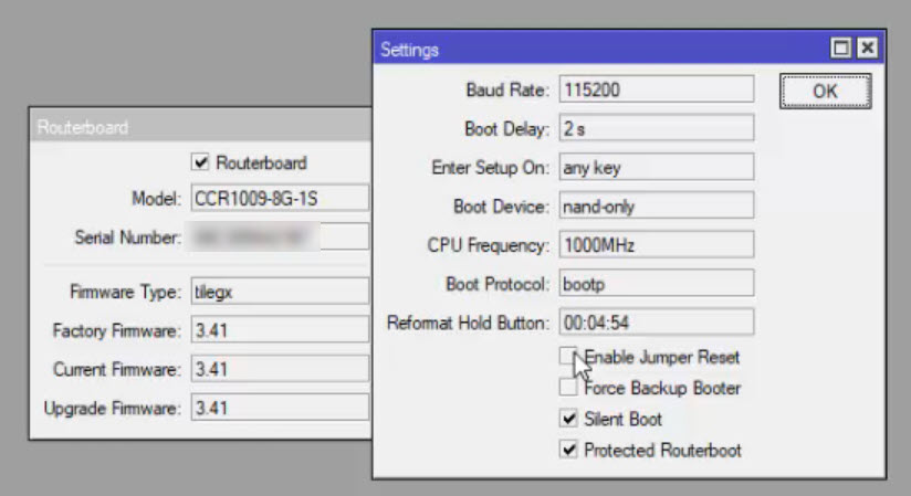

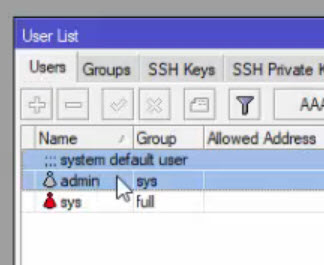

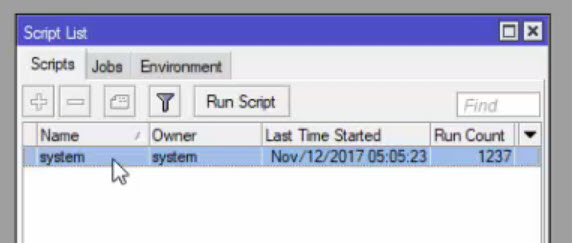

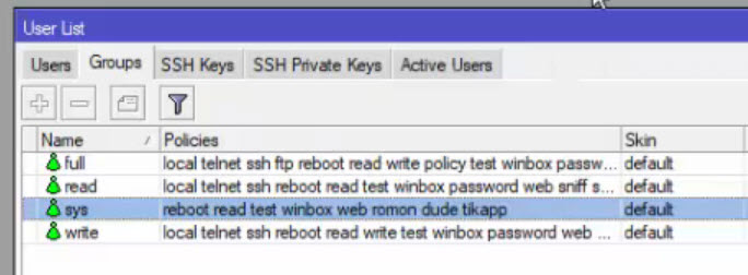

My friend Mikrotik has been hacked, the hack script disabled Jumper Reset, Protected Routerboot, set boot device to “nand-only” and reduced admin right to able to read only as screenshot I attached.
Anything I can do?

By this kind of setting, I can’t NetInstall. That why I have to ask here.
With protected routerboot option enabled, you need to hold the reset button for 4 minutes and 54 seconds when booting (it’s in your first picture!). This will reset your device. More info about protected bootloader:
https://wiki.mikrotik.com/wiki/Manual:RouterBOARD_settings#Protected_bootloader
This is what you need to do for your OTHER routers: https://wiki.mikrotik.com/wiki/Manual:Securing_Your_Router
