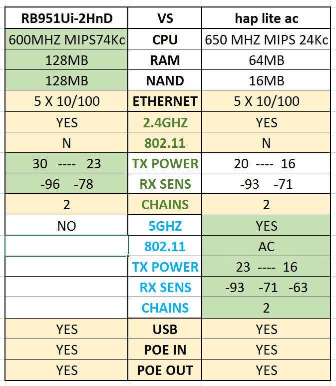

i made a comparison chart
some years ago the goal in wifi was coverage (some people still think that) but in today wifi the goal is capacity, for that goal the hap lite ac is a better choice because that additional 5ghz radio let you easily double your wireless network capacity with the same number of access-points, and the tx power is enough to cover a decent and contained area to guarantee performance
rb951Ui-2hnd has served as a very good single radio 2.4ghz AP, and has the muscle to operate as a very capable small independent AP/Router + Hotspot with their own logging and graphs
as always in wifi the last word depends on the specifics of your scenario
The best think you can do is to test with both devices to know which one fits better
in wifi you need to do pre-deployment simulated design, then validade with ap on stick pre deployment survey, then install, and finally a post deployment survey to validate instalaltion acomplish design objectives and client requeriments
