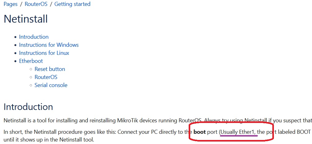

https://help.mikrotik.com/docs/display/ROS/Netinstall

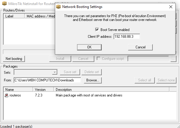

However, the routers/drives have not been detected, and RouterOS installation cannot proceed.
So at which point exactly things start to deviate from expected progress? That’s not clear from your post at all.
Netinstall can’t detect the device, that’s why I can’t install the firmware, I’m still stuck with no ethernet and no wifi.

Which port are you using? The cable must be directly connected from hAP unit port 1 (no other port) to your computer. in the computer, disable wifi and other interfaces, only the LAN interface that is connected to router port 1 must be enabled

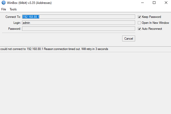

Try using winbox, as mentioned by @erlinden the neighbours tab page will display the list of Mikrotik devices found by winbox. If the list remains empty, try connecting computer to different ether ports of your router, discovery isn't allowed through all ports (depending on configuration).
If router does show on the list, try clicking its MAC address ... this way winbox will connect via MAC and will thus bypass any IP configuration problems there might be.
What @normis writes is true for netinstall and the opposite is true for winbox (with default configuration).
I’ll try this way thank you. I will feedback later.
It worked thank you. But my question is why isn't it detected with 192.168.88.1 in the browser when connected through ethernet?

Probably netinstall requires port 1 (which is by default the WAN port and therefor will not have an IP address).
After a succesful netinstall, you should connect to any other port then port 1 to manage the device.
