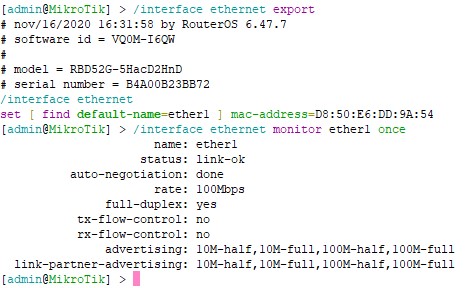

Screenshot of both commands output is attached.
As I said, changing cable is currently not an option. The tech guy checked the RJ45s with a multimeter and said they are OK.
Neither your hAP ac2, nor the device on either end is advertising 1Gbit.
Huh?
Why is advertising limited to 100Mbps? There is nothing in the config. RouterOS reacting on cable? (Not all 4 wire-pairs connected?)

Is that what you asked for?

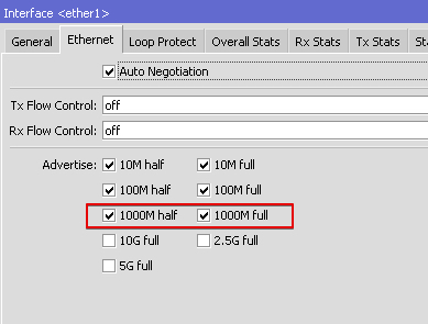

Check, that you advertise 1000M:
If you remove the 1000M in the GUI, this is shown in the config export.
set [ find default-name=ether4 ] advertise=10M-half,10M-full,100M-half,100M-full
That’s what I don’t understand. The hAP ac2 NOT advertising 1000M without config setting ? Even setting a MAC address is with OP’s config is not related.

What happens with the advertising when there is NO cable attached to that port ??
Only difference I see is the ROS version. But that would be a major bug in 6.47.7 .
[admin@MikroTik] > /interface ethernet monitor ether1 once
status: no-link
auto-negotiation: done
advertising: 10M-half,10M-full,100M-half,100M-full,1000M-half,1000M-full
This is what I get with no cable plugged on ether1
Amazing ! No?
So the port advertises 1000M , but drops to advertising 100M when that cable is plugged in.
