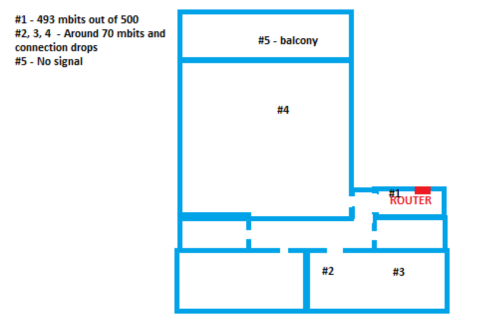

I have been trying different settings to get a decent coverage and speed with my new router with the 5GHZ band but I cannot seem to find a solution.
Any help would be much appreciated.
With Asus RT-AC86U I get full coverage at points #2,3,4 with around 440mbits and get coverage even in my balcony at #5.
I have tried using different countries including mine, set “TxPower” to 30-40, and “Antenna Gain” to 0 but those even lessened the coverage somehow.
The following is my apartment plan and is around 95 square meters:

Why don’t you use the lower channels 5160-5340 (UNII-1 and UNII-2A)?
The channels you use now, are subject to reduced TX power AFAIK.
Nothing Mikrotik can do about it, they are pretty strict in following regulations for that aspect.
Which channels does Asus use ?
They are being used by my neighbours.
Asus was fixed to use channel 100.
I just tested it again with frequencies 5250-5330 and got slightly worse performance. 436mbits next to the router and around 50 on the other locations, with no range improvement.

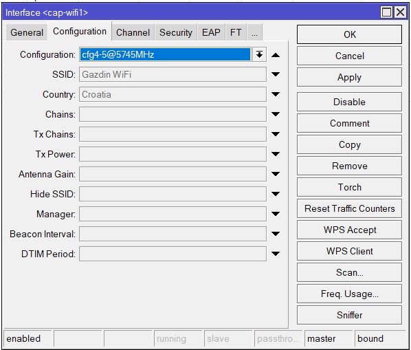

In the documentation:
https://help.mikrotik.com/docs/display/ROS/WifiWave2
You can find it in Wireless → WiFi Wave2 → then when you select interface you want to configure you will get this:
Here you have TX power and antenna gain. I leave antenna gain default and change tx power if needed.
But where does it show what the actual gain and tx power settings currently are??
