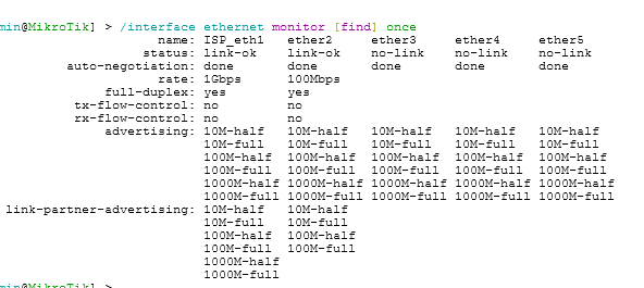

Znevna
April 6, 2022, 3:50pm
9
/interface ethernet monitor [find] once
And see which port doesn’t have rate = 1Gbps.

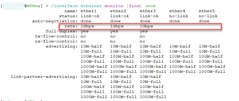

Quick check is indeed as Znevna suggests. See what the ports advertise.
Anyhow, the fact you only get 70-90 makes me conclude there is somewhere a 100Mb restriction to be found.
This is how it should look like:
sb101
April 6, 2022, 7:32pm
12
Ok, so I guess that confirms where the issue lies - guess the second cable might be the culprit?
