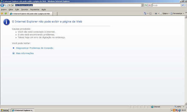

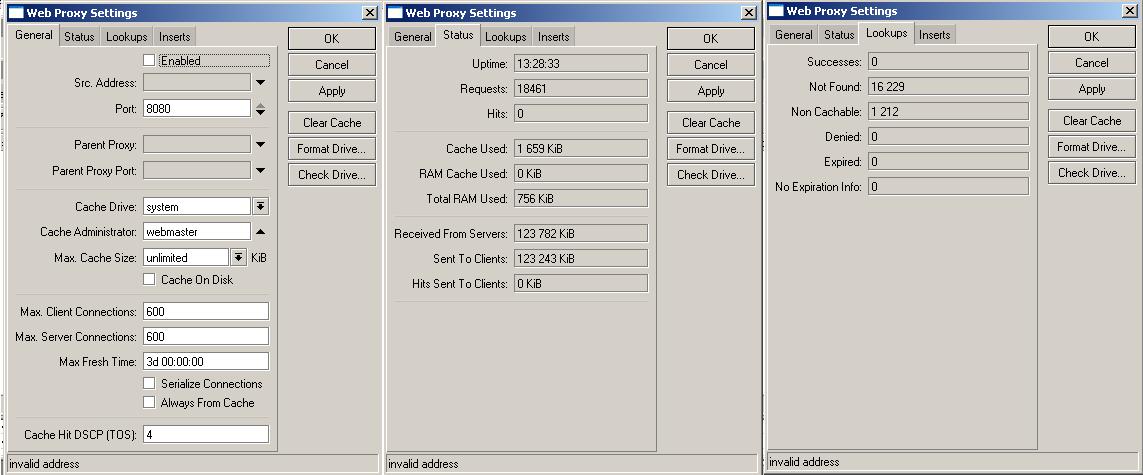

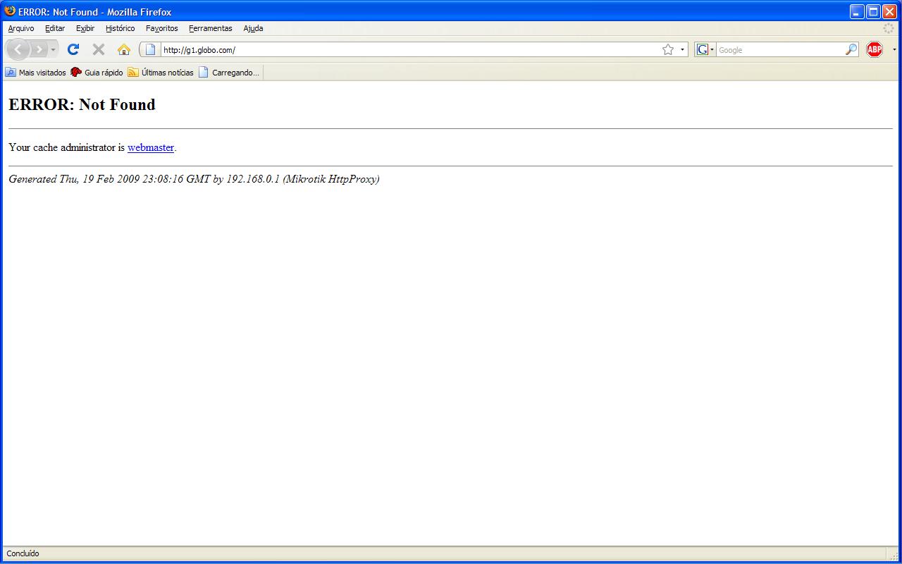

Im attaching two print screens, one with the web browsers showing when Mikrotik web proxy declined to serve hotspot page, and another when the web proxy was almost dead. In both situations, the ips on binding list were surfing normally.

    The box “Enabled” at Web proxy settings is unchecked, i think it’s because we don’t use web proxy itself, it is only used by the MK to serve the hotspot login and status pages.

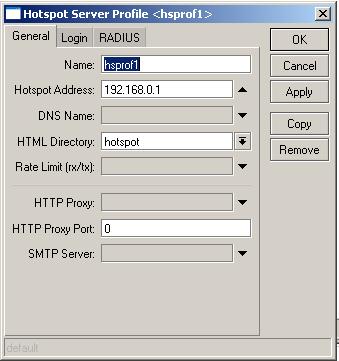

Here goes the first screenshots of my config.

My hotspot is being called only by the IP address. (192.168.0.1)

Webproxy config
Start by setting the max-cache size to none and do a reboot as well if you can. The web-proxy is a part of the hotspot in that it is part of how users get redirected to the login page (I think, I’m going mainly on tests i’ve done and some info that mikrotik have replied with when I’ve had problems with earlier versions).

I face the same problem and it occurs almost 5 times in a 12 hour period. Its definately a problem with the web proxy. I have noticed that if there is 0.0.0.0 in the ip> dns , then people see the “web administrator is webmaster” error. As earlier said, clients on bypass are able to browse and they can get to wall garden sites.

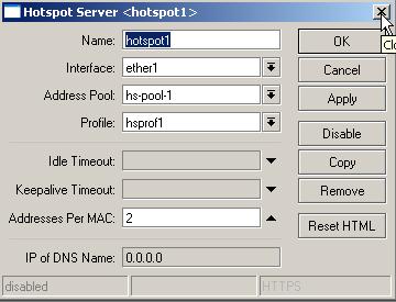

When this issue happens, disable and then reenable the hotspot server. If the IP OF DNS NAME shows 0.0.0.0 .By disabing and then immediately reenabling, the ip address will be set to the ip address of the hotspot server and clients can browse.

The web proxy that you can see and configure via Winbox or command console is not the same proxy that is used by the internal hotspot. In fact, in the Winbox screenshots in hrodriguesvt’s post it is clearly showing that the proxy is not enabled, yet there clearly IS a proxy enabled, otherwise the hotspot would not work at all. As said, this is because the screenshots are not of the internal proxy used by the hotspot.
