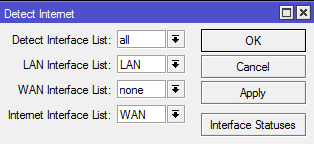

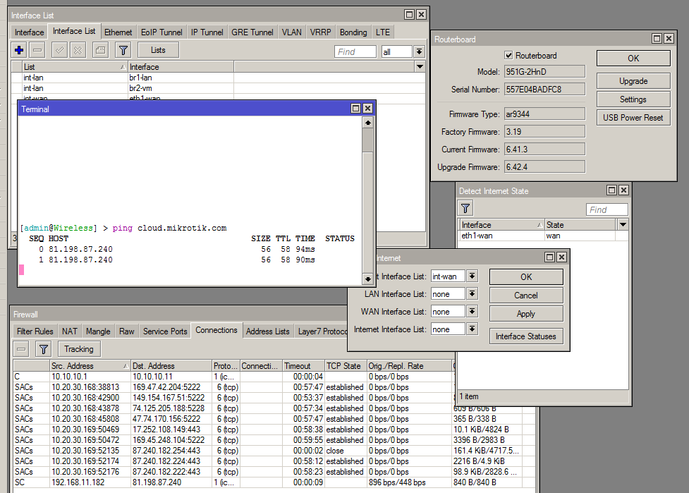

Try to test new future: /internet detect. I have enabled it on wan interfaces, but mkt do not change status to “internet”. and i do not see connections to cloud.mikrotik.com:30000, as written on wiki. It’s a bug?
All information on screenshot:

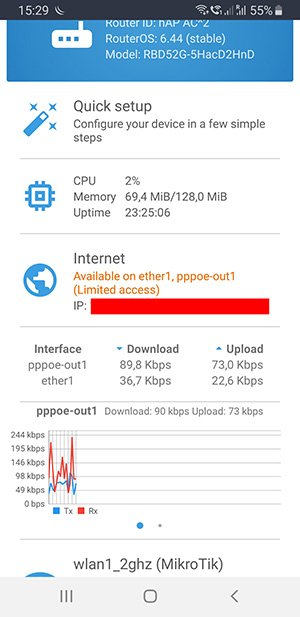

Also, in mobile app I can see “Available on ether1 (Limited access)”.
Enabling it turned on my internet speed graph in mobile app. However thing I cannot understand is difference in speeds between pppoe-out1 and ether1 - for my understanding that should be exactly the same, as my ISP cable is plugged into eth1.
