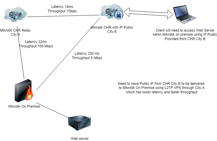

Which is pretty much has been solved before. However, now I am facing another challenge on this. The ISP that I am using has very bad connection when connecting to the CHR server on City A, it gives slow throughput and slower speed. On the other hand, connecting to CHR on City B is good, faster speed and lower latency. What I would like to accomplish to have L2TP VPN using BCP, but using CHR City B as middle man in the process when creating tunnel. Please see the image below:
https://imgur.com/qPX3QiV
Please advise how to configure this on Mikrotik CHR City A, City B and Mikrotik on Premise

The IP address on CHR City B is being delivered straight to Mikrotik on premise. So when Mikrotik on premise dial L2TP VPN, It will be getting IP Public straight from CHR City B using L2TP BCP method. What I am trying to accomplish is, using the same layer 2 method to deliver IP Public from City B through City A CHR. Port forwarding only happened on Mikrotik on premise, since it is the only Mikrotik that will be getting IP Public and port forward to internal LAN behind it.

Let me add more information to make it more accurate. I am sorry for not providing accurate information
The IP address on City B is 129.90.90.2/24. The normal setup, mikrotik on premise will dial L2TP and getting IP address from the City B range which would be 129.90.90.3 on L2TP interface. However, the direct connection from on premise to City B is not good, so I have to relay the L2TP to City A in order to get better connectivity. However, I couldn’t figure out on how to get the IP address delivered to L2TP dial on Mikrotik on-premise via layer 2. The port forwarding will happen on premise, since the on premise mikrotik will be getting IP Public from City B IP range.
I tried before was dialing create 2 LT2P connection. First L2TP is to connect to City A, then 2nd L2TP would be connect to City B, via City A L2TP tunnel. I just don’t like the result as it creates more overhead which degrading the performance, especially the CHR doesn’t have very good processor when handling too large bandwidth.
Thank you
I think I do understand what you want. My suggestion keeps the L2TP tunnel between the on-premise Mikrotik as a client and City B Mikrotik as a server; the CHR in City A doesn’t serve as neither an L2TP client nor an L2TP server. The only thing it does is that it forwards the L2TP transport/control packets received from the on-premises Mikrotik further to 129.90.90.2 thanks to the dst-nat rule, and makes the CHR in City B send response packets to itself (the CHR in City A) thanks to the src-nat rule. So it acts as a simple router with NAT and its sole purpose it to force the networ path between the client and the server to be the “good” indirect one rather than the “bad” direct one.
I think the City A forwarding L2TP traffic is good idea, how to accomplish that on City A CHR settings and on premise, when dialing L2TP, which IP should be use to dialing L2TP, is it CHR City A or CHR City B IP Public?
Thank you
Everything as stated in post #2, except that you swap the roles of CHR A and CHR B.
