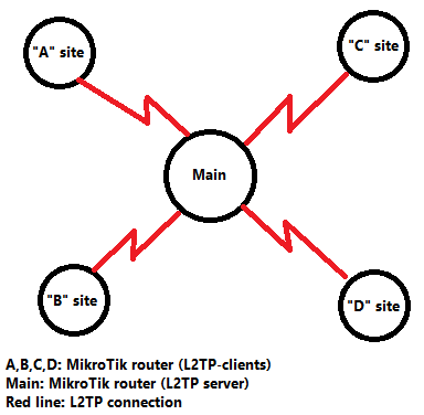

Our customers use many MikroTik gateways. The routers are connected in a star topology with L2TP/IPsec VPN. The main router is L2TP server, the site gateways connect there with L2TP client interface. When the internet connection down for a few minutes (on the site gatways), the L2TP connections are not re-established (if the internet connection is ready again.)
Example:
- L2TP/IPSec VPN is working between the central (main) router, and the sites routers.
- Internet connection of a site router will be lost for a few minutes (e.g. site “A”) - Usually internet connection problem caused by ISP.
- Internet connection is UP again.
- The site router (e.g. site “A”) can’t reconnect to central (main) router with L2TP/IPsec.
