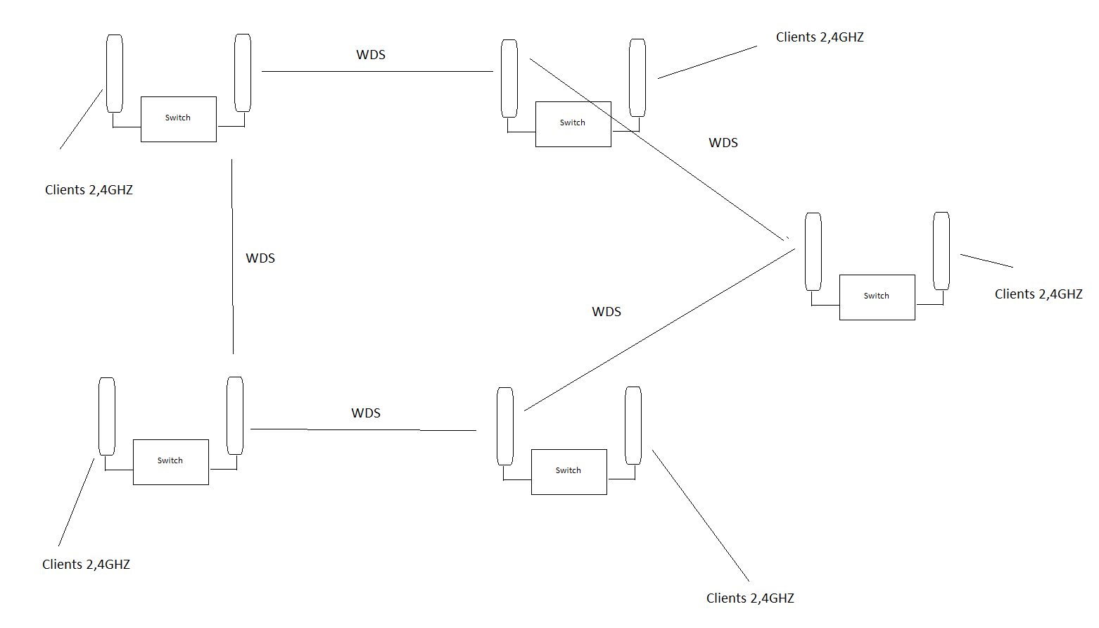

I have multiple boxes with 2x MikroTik Metal 52 ac (OS 7.7) connected over a switch. One Metal 52 ac acting as AP for clients (2.4GHz) and the other is working in the 5GHz frequency as backhaul.
Each of these boxes should connect to another box via the 5GHz freq. My first idea was to just use WDS and OSPF as routing protocol. This worked for a amount of 4-5 boxes. More than that and problems accoured.
Now i resetted all my confugurations and am trying to use just HWMP for meshing and routing like this:

Problem here: I
f I am using dynamic WDS mode the AP will randomly disconnect and reconnect with another wds connection of the same AP (number is increasing wds1 ,wds2 ..)
If I am using static WDS mode the connection will also randomly disconnect and reconnect after some time. This result in a high unstable connection wich is unsuitable for live cam’s.
